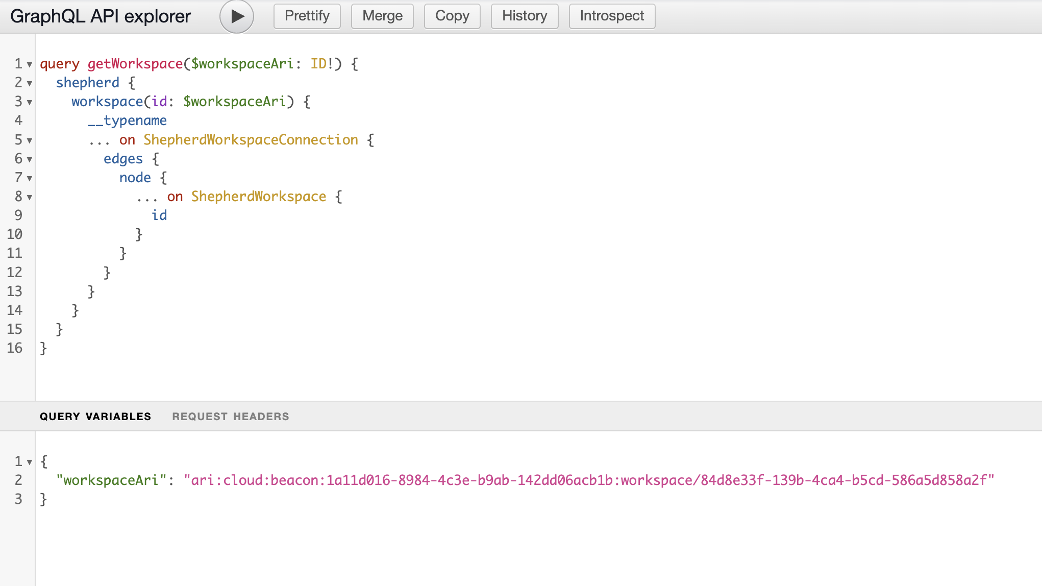

Example GraphQL query
To get you started, here's an example query that fetches data about a Guard Detect workspace.
  1. Open the API explorer
  2. Paste this code into the main query window:
    1
    2
    query getWorkspace($workspaceAri: ID!) {
      shepherd {
        workspace(id: $workspaceAri) {
          __typename
          ... on ShepherdWorkspaceConnection {
            edges {
              node {
                ... on ShepherdWorkspace {
                  id
    Note that Shepherd is an internal name for Guard Detect functionality.
  3. In the query variables window, paste this code:
    1
    2
    { "workspaceAri": "your-workspace-ari-here" }
  4. Replace the string your-workspace-ari-here with your workspace ARI.
  5. Press the execute query button (triangle icon) at the top of the screen. Details about your workspace will appear in the panel on the right. The GraphQL API explorer window with example code.
