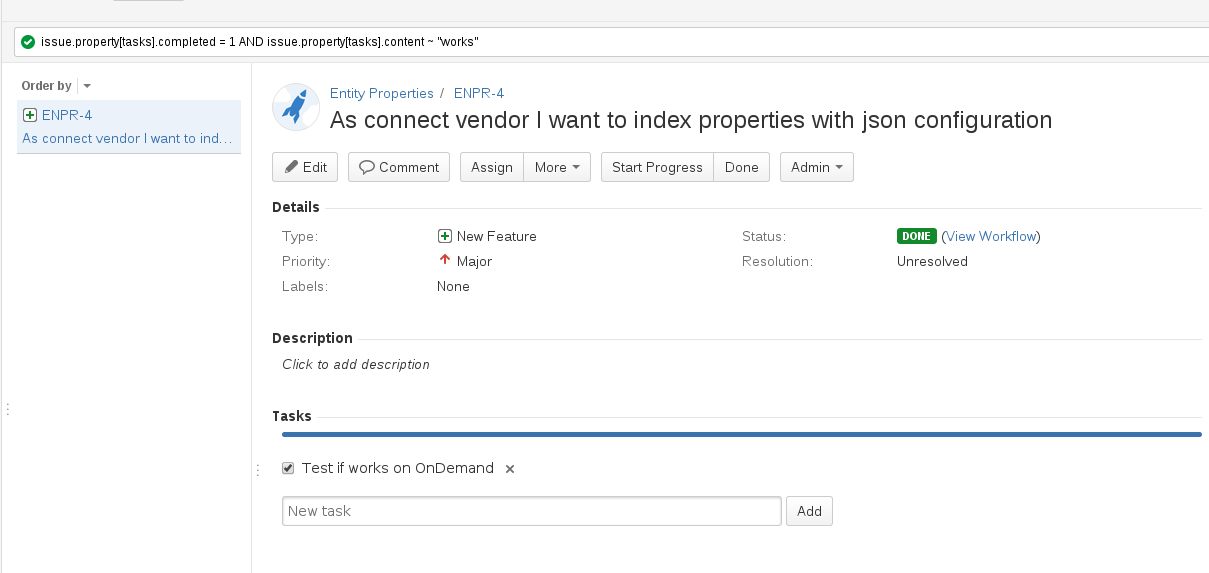

The descriptor above will make Jira index the object "content" of the issue property "tasks" as a text. The available index data types are:
The indexed data is available for a JQL search. The JQL query...
1
2
issue.property[tasks].completed = 1 AND
issue.property[tasks].content ~ "works"
...result is shown in this screenshot.
Alt text
