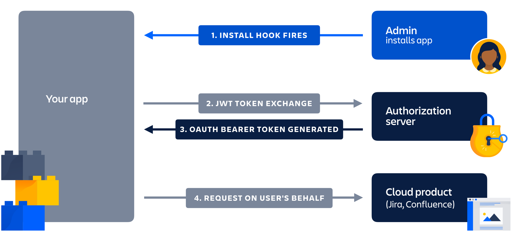

Flow for user impersonation authorization grants
The flow for accessing a user's resources works as follows:
The connect OAuth impersonation flow
  1. Install hook fires with the oauthClientId and the shared secret.
  2. App creates a JWT assertion with the shared secret and the oauthClientId, and then POSTs it to the authorization server.
  3. Authorization server returns an OAuth 2.0 access token.
  4. App uses the access token to perform actions as a user.

For an app to make requests on a user's behalf, you need an OAuth 2.0 access token. These steps describe how a token is retrieved:
  1. Admin installs the app: This initiates the installation handshake with the oauthClientId and the shared secret in the request body:
    1
    2
      "key": "addon-key",
      "oauthClientId": "your-oauth2-client-id"
  2. JWT token exchange: The app creates an assertion, a JWT that is HMAC-SHA256 signed with the shared secret the app received during the installation handshake, and adds these claims in the payload:
    AttributeTypeDescription
    issStringThe issuer of the claim. For example: urn:atlassian:connect:clientid:{oauthClientId}
    subStringThe subject of the token. For example: urn:atlassian:connect:useraccountid:{account ID of the user to run services on behalf of} Note: urn:atlassian:connect:userkey:{userkey of the user to run services on behalf of} has been deprecated.
    tntStringThe instance the app is installed on. For example: https://{your-instance}.atlassian.net. For a Confluence instance, add /wiki to the end.
    audStringThe Atlassian authentication server: https://oauth-2-authorization-server.services.atlassian.com
    iatLongIssue time in seconds since the epoch UTC.
    expLongExpiry time in seconds since the epoch UTC. Must be no later that 120 seconds in the future.
  3. OAuth bearer token generated: The assertion and the payload are POSTed to the authorization server: https://oauth-2-authorization-server.services.atlassian.com/oauth2/token

  4. Requests on user's behalf: The token endpoint validates the signatures and issues an access token.
