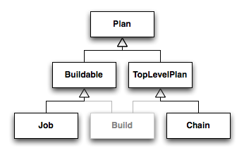

Both the Chain and the Job extend the Plan interface and share the one database table. There have also been two common interfaces introduced to help deal with commonalities between the implementations (TopLevelPlan and Buildable).  As the Build class has now been deprecated most of Bamboo's internals have been updated, this includes managers and our plugin interfaces.   Each case is different, but you will find some methods now deal with Plan, TopLevelPlan or Buildable, others will deal directly with the Chain or Job, whilst others will happily deal with all 5, you just have to tell it which one your after.  When developing your plugin, if you are passed a common interface,  you will need to ensure that the operation you wish to perform is actually applicable to the specific implementation.
Jobs are grouped in a Chain by ChainStages. ChainStages have a specific order inside the Chain, whilst Jobs inside a ChainStages do not have any order. The diagrams below shows the relationships and hierarchy of the new classes (The Build object has been included in the diagram to help explanation)
As jobs are a child of the chain, the identification key of the job also includes the full key of the chain.  For example, a chain is represented by  "BAMBOO-TRUNK" whilst the job is "BAMBOO-TRUNK-UNITTESTS".

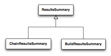

The structure of result objects follows the same pattern as the plans.  ChainResultSummary and BuildResultsSummary (Job) share the common interface ResultsSummary.  Job results are grouped by ChainStageResult.

The TriggerReason interface (Trigger Reason Module) has been updated to take in a ResultsSummary instead of a BuildResultsSummary.  You will need to ensure any implementations of this will work with both Chains and Jobs.  Also, it should be noted that Jobs do not have their own Trigger Reason, they will inherit the trigger reason of their parent.
Web Repository Module
The WebRepositoryViewer methods have also been updated to accept a ResultsSummary instead of a BuildResultsSummary and therefore also needs to be updated to support Chains as well as Jobs.
Report Module
The ReportCollector interface has been updated to accept a ResultsSummary instead of a BuildResultsSummary and therefore also needs to be updated to support Chains as well as Jobs.
