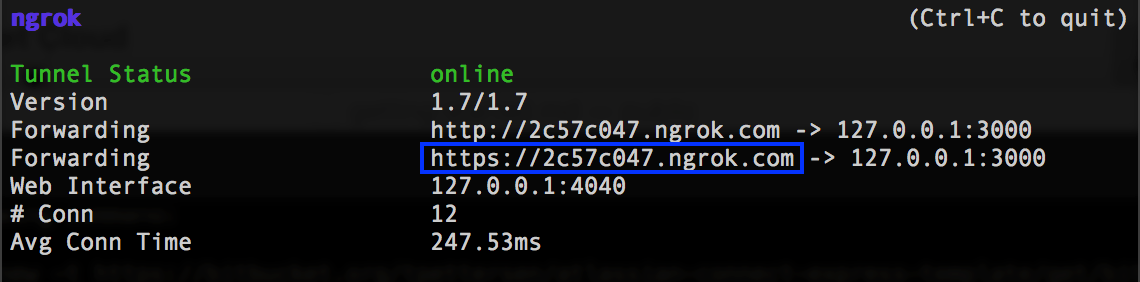

  4. Open a new shell and run the following command: ngrok http 3000. This will expose a local port on your machine to the Internet which the app can use to communicate with Bitbucket. Leave this running in your shell. You'll see output similar to this: ngrok
  5. Copy the https forwarding address from the response, highlighted in blue in the preceding example.
  6. Open a new shell (in addition to the one running ngrok) and start the node process with the following command (Replace the URL https://2c57c047.ngrok.com/ with the https:// address you copied from ngrok).
