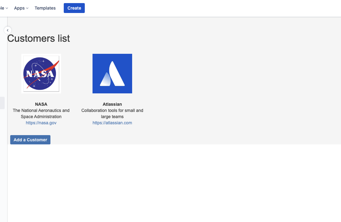

Displaying all Customers
In previous lesson, we created a generalPage for this with key customerList that routes to /list-customers. Let's implement that page now:
  1. Firstly, we add /list-customers to our routes:
    routes/index.js
    1
    2
    app.get('/list-customers', addon.authenticate(), function (req, res) {
            var spaceKey =  req.query['spaceKey']
            res.render('list-customers', {
                spaceKey: spaceKey
  2. Next up, we define the view to get all Customers and display them:
    views/list-customers.hbs
    1
    2
    {{!< layout}}
    <div id="customers-list" style="margin-top: 50px;"></div>
    <script>
    $(function(){
      AP.request({
          url: "/rest/api/content/",
          data: {
            "type": 'ac:custom-content-tutorial:customer',
            "spaceKey": "{{spaceKey}}",
            "expand": "children"
          success: function(response){
            let customers = JSON.parse(response).results;
            customers.forEach(customer => {
                    AP.request({
                        url: `/rest/api/content/${customer.id}/property/customer-data`,
                        success: (jsonData) => {
                            jsonData = JSON.parse(jsonData);
                             $("#customers-list").append(`<div id='${jsonData.id}' style='width: 200px; height: 213px; text-align: center'>
                                                            <img onclick='window.top.location="${jsonData._links.base}/display/{{spaceKey}}/customcontent/${customer.id}"' src="${jsonData.value.logo}" alt="Logo" width="128" height="128">
                                                            <h5 class='company-name'>${jsonData.value.companyName}</h5>
                                                            <div class='description'>
                                                                ${jsonData.value.description}
                                                            </div>
                                                            <a href='${jsonData.value.website}'>${jsonData.value.website}</a>
                                                            </div>`)
          error: function (err) {
                console.log("err - ", err)
    </script>
    Let's see what's happening here:
    • We first added the HTML div with ID customers-list where all the Customer details will be displayed.
    • Then, we made a GET request to /rest/api/content/ to fetch details for our custom content type under the current Space. We have a parameter called expand, which specifies additional data to fetch. We specify the value children to retrieve all the Customers (ie. the "children") within the Space (the "parent"). However, this returns only the Customer IDs. We need a way to store and fetch the actual details of each Customer.
      We will store the details of the Customers in a content property, named customer-data. So, we fetch this content property for each Customer by making GET requests, one request per Customer, to /rest/api/content/<customer-id>/property/customer-data. This data is then rendered onto the page.

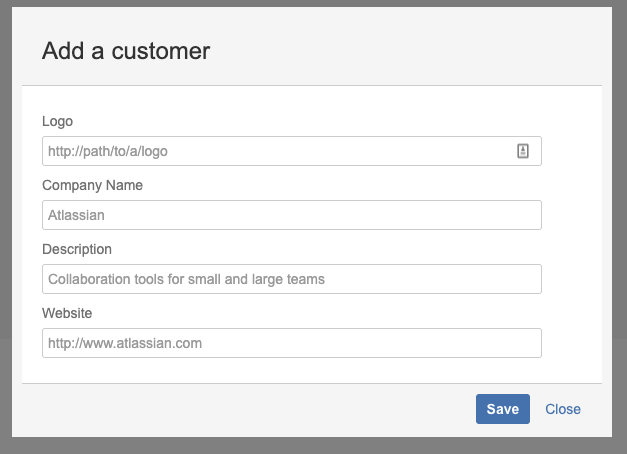

Creating a customer
Let's set up a basic dialog that looks like this:
add a customer
To achieve this, we need to do four things:
  1. Setup a dialog module in our descriptor. This is done by adding the following to modules
    atlassian-connect.json
    1
    2
    "dialogs": [
        "key": "newCustomer",
        "url": "/add-new-customer?spaceKey={space.key}",
        "options": {
          "height": "420px",
          "width": "600px",
          "header": {
            "value": "Add a customer"

  3. When the "Add a Customer" button is clicked, the dialog box opens up and requests /add-new-customer as defined in step 1. Let's add that route:
    routes/index.js
    1
    2
    app.get('/add-new-customer', addon.authenticate(), function (req, res) {
      res.render('new-customer', {
          spaceKey: spaceKey
  4. Create a new file with the dialog's view:
    views/new-customer.hbs
    1
    2
    {{!< layout}}
    <div>
      <header class="aui-dialog2-header">
        <h2 class="aui-dialog2-header-main" id="static-dialog--heading">Add a customer</h2>
      </header>
      <div class="aui-dialog2-content">
        <form id="add-customer-dialog" class="aui top-label new-customer-dialog">
          <div class="field-group top-label">
            <label for="logo">Logo</label>
            <input class="text long-field" type="text" id="logo" name="logo" placeholder="http://path/to/a/logo" />
          </div>
            <label for="companyName">Company Name</label>
            <input class="text long-field" type="text" id="companyName" name="companyName" placeholder="Atlassian" />
          </div>
            <label for="description">Description</label>
            <input class="text long-field" type="text" id="description" name="description" placeholder="Collaboration tools for small and large teams" />
          </div>
            <label for="website">Website</label>
            <input class="text long-field" type="website" id="website" name="website" placeholder="http://www.atlassian.com" />
          </div>
        </form>
      </div>
      <footer class="aui-dialog2-footer">
        <div class="aui-dialog2-footer-actions">
          <button id="dialog-save-button" class="aui-button aui-button-primary">Save</button>
          <button id="dialog-close-button" class="aui-button aui-button-link">Close</button>
        </div>
      </footer>
    </div>
To check out more markup and UI components, check out the AUI documentation.
