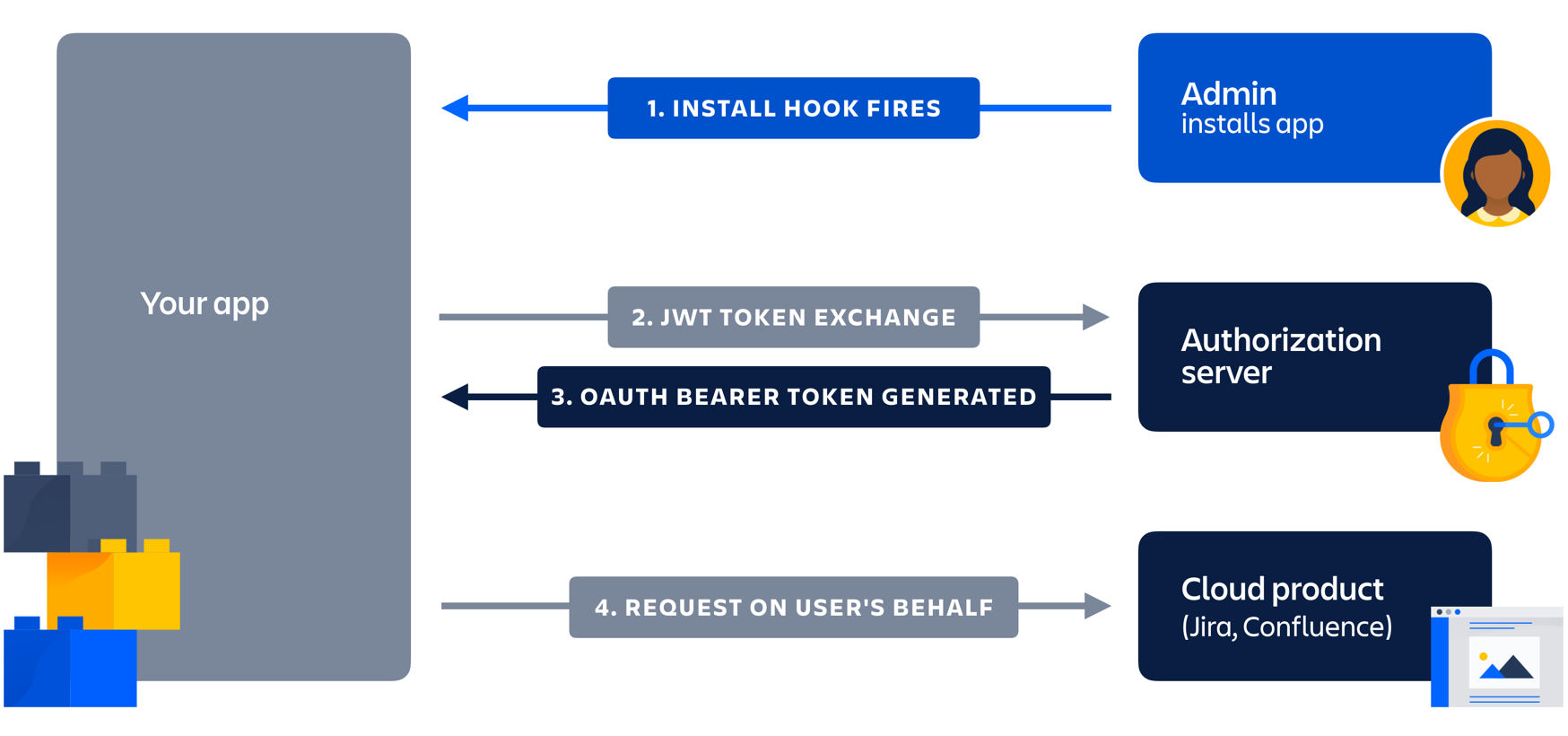

Flow for user impersonation authorization grants
The flow for accessing a user's resources works as follows:
The connect OAuth impersonation flow
  1. Install hook fires with the oauthClientId and the shared secret.
  2. App creates a JWT assertion with the shared secret and the oauthClientId, and then POSTs it to the authorization server.
  3. Authorization server returns an OAuth 2.0 access token.
  4. App uses the access token to perform actions as a user.
