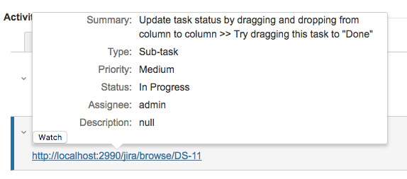

Other examples
The examples in this section show you more advanced use cases for the REST API, like calling the REST API from a script or an app.
Examples in this section:
  • Calling the REST API from a script: Graphing image links.
  • Calling the REST API from an app: Quickview inline dialog app.
This example shows you how to write a small python script that will use REST interface to graph the relationships between issues in Jira site.
To simplify the REST requests, you can use the small helper library called restkit. This library is not strictly necessary – after all, REST is just an HTTP. However, restkit can be used for convenience. You also rely on pygraphviz to do the actual graphing for you too. To use it you will need Graphviz installed.
This example shows you how to create a Jira app that uses the REST API. We want to look through all the comments on the issue and add a little tooltip that will pop-up when you hover over a link to a Jira issue.
The pop-up should contain a "quick view" of information about the target issue (similar to the example shown in the following image) so that you do not have to click the issue's link to see this information.
You can achieve this by using a Web Resource Context. This lets your app put JavaScript just on the View Issue page of Jira.

You can view the full demo app on Bitbucket.
