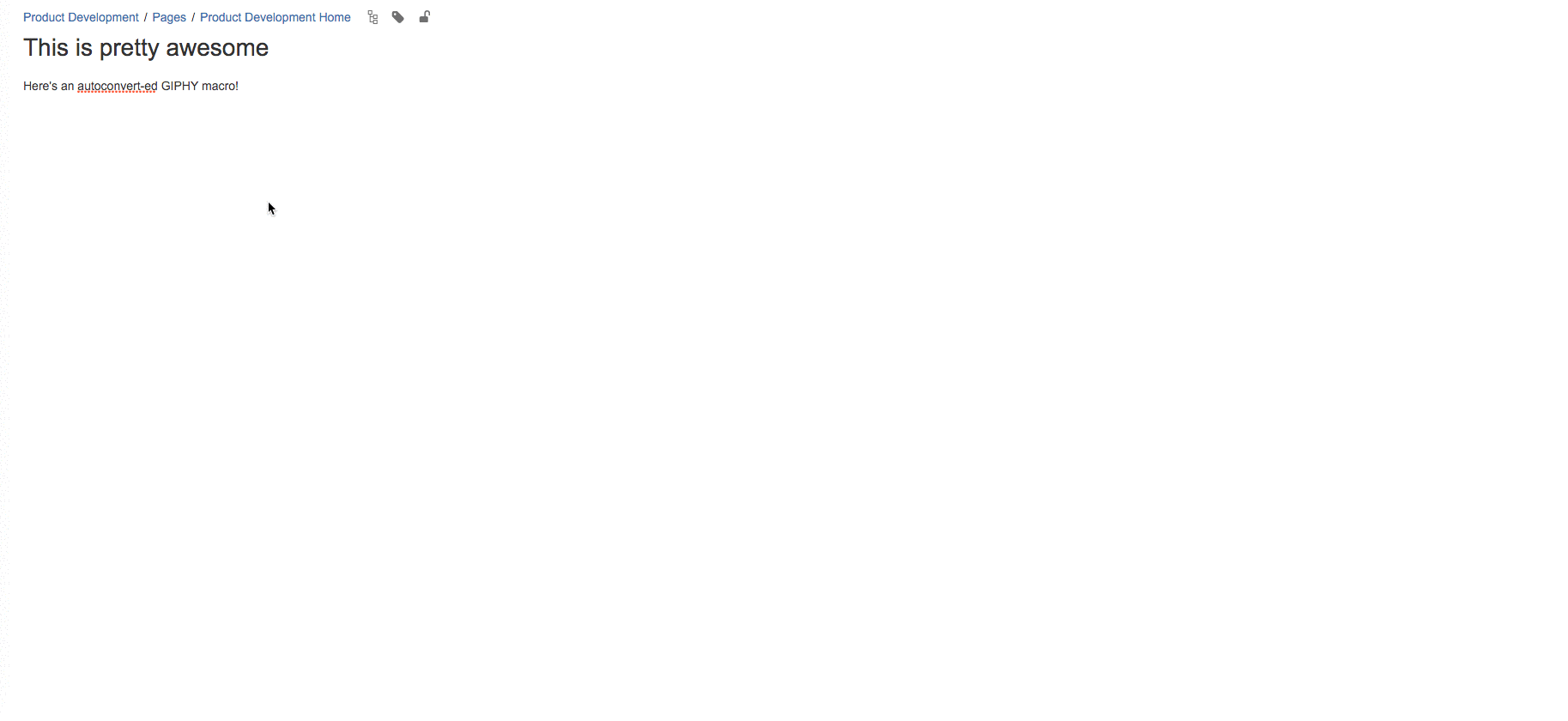

Let's take a quick look at macro autoconvert — a feature which allows for intelligent insertion of macros to the Confluence Editor (below is also a sneak peak of the Macro Custom Editor with Confluence Connect).
macro autoconvert giphy
So, what happened here?
Autoconvert: We pasted the link, http://giphy.com/gifs/l3E6xxDZC4AADCAE0, into our Confluence page, and it auto-created an instance of the GIPHY macro, with this URL set.
As a developer, this gives you extra control over the behavior of the macros you introduce into Confluence. Pretty awesome, right? Let's take a look at how to do this. ** **

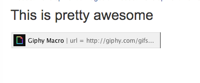

Creating a macro through autoconvert
What more is involved here?
Nothing, that's it! Try pasting a link such as http://giphy.com/gifs/applause-clapping-clap-aLdiZJmmx4OVW into your Confluence editor. You should see the following:
this is pretty awesome giphy
Simple and awesome!
