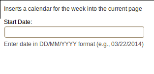

  3. Open the properties file in the resources directory, examplemacro.properties, and add the following properties to the file:
    1
    2
    com.example.plugins.tutorial.confluence.examplemacro.examplemacro.param.date.label=Start Date:
    com.example.plugins.tutorial.confluence.examplemacro.examplemacro.param.date.desc=Enter date in DD/MM/YYYY format (e.g., 03/22/2014)
    These will provide the label and description for the parameter in the macro browser, as shown here:

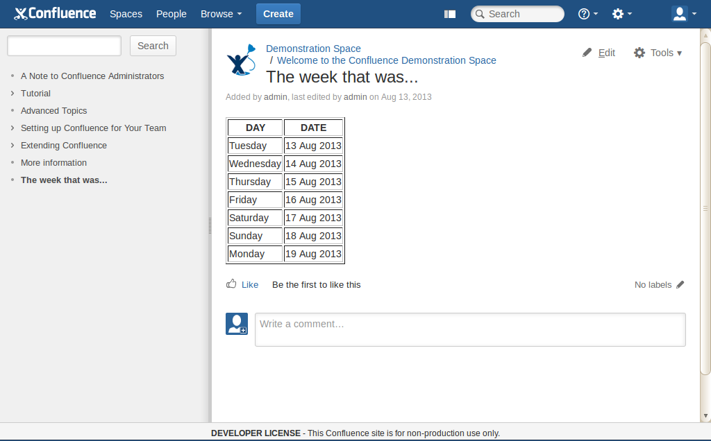

As you saw in the preview pane and on the page after saving your changes, so far the macro generates our placeholder text, "Only a test". We'll make it do more next.
You can keep Confluence running at this point,  QuickReload will automatically redeploy any changes you build.

  3. Back in the Confluence browser window, try adding your macro again. This time, you should get the default calendar in the preview pane.
  4. Enter a date in the Date field using the dd/mm/yyyy format, such as 22/09/2014 for September 22, 2014.
  5. Click Insert.
  6. Click Save to view your macro output.
