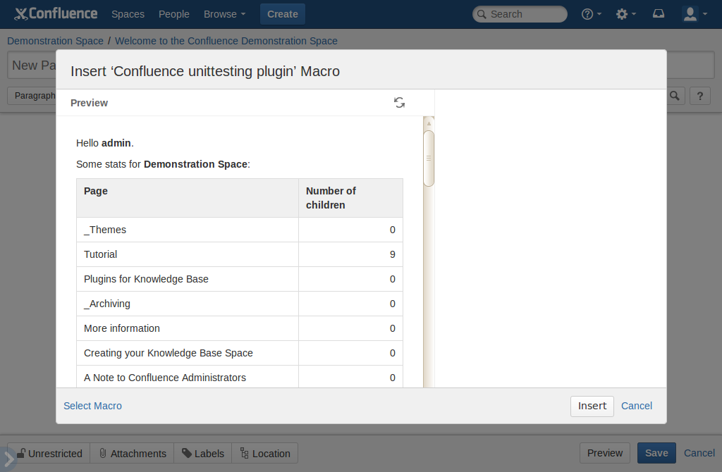

  5. Start your Confluence instance and test your plugin. To start Confluence, run this SDK command from the project root directory:
    1
    2
    atlas-run
  6. Once Confluence starts up, log in using the default user name and password, admin/admin.
  7. Create a new page and try adding a macro. Look for a macro named Confluence unittesting plugin in the macro browser and make sure you can add it to a page. To find it quickly, you can start typing its name in the search field to filter for it, "unittesting".
This macro lists the pages created in the last 55 days in the Demonstration Space (space key: DS). The DS space is built into our dev Confluence instance. Since this is a new Confluence installation, that would be all of them. If for some reason you don't have the DS space, the macro won't work.

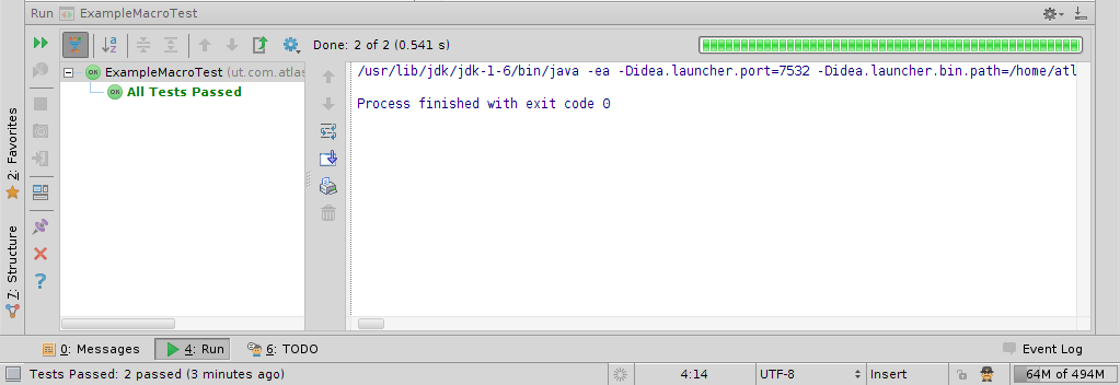

    @Test
    public void testOutputIncludesRecentPages() throws Exception
      // Test code will go here
This shows the basic ingredients of a unit test written with JUnit:
    • We've added all the import statements we'll need later. Along with other imports, we're importing our plugin package, ExampleMacro. This lets the test invoke its functions and check results.
    • Notice the import of the Mockito packages. They give us the ability to create mock objects to use in place of the Confluence classes for testing. We'll talk more about Mockito mock objects below.
    • The class name is the same as the class we're testing appended with Test.
    • Each test method (line 34) is annotated with @test and has the public void signature. We only have one for now, but will add a second one later.
Add the code for the test method, testOutputIncludesRecentPages():
1
2
3
4
5
6
7
8
9
10
11
12
// create test page
Page page = new Page();
page.setTitle("Page title");
// set up stub method to return our test page
when(pageManager.getRecentlyAddedPages(55, "DS")).thenReturn(Arrays.asList(page));
// create the macro
ExampleMacro exampleMacro = new ExampleMacro(pageManager, spaceManager);
// verify that the output contains the page title
String output = exampleMacro.execute(new HashMap(), "", conversionContext);
assertTrue("Output should contain page title but was: " + output,
      output.contains(page.getTitle()));
The method tests the output of the macro to make sure it includes recent pages. Notice the code comments in our test method. They describe each line of the test. Other points to note are:
JUnit provides a variety of assertion methods to all subclasses of TestCase. The three most common are assertEquals, assertTrue and assertFalse. These methods check the condition implied by their name and throw a particular kind of exception if the condition is not true. JUnit checks whether that exception is thrown and marks the test as failed if it is.
As shown in our test class, Mockito mock objects are initialised using the MockitoJUnitRunner class.
1
2
@RunWith (MockitoJUnitRunner.class)
This initializes the objects we want mocked (those annotated with @Mock). We can then have the tests create mock instances of the PageManagerSpaceManager and ConverstionContext interfaces by applying the @Mock annotations, as follows:
1
2
3
4
5
6
7
@Mock
private PageManager pageManager;
@Mock
private SpaceManager spaceManager;
@Mock
private ConversionContext conversionContext;
With a Mockito mock, by default, any method call on the object will do nothing and return the default value for the method's return type. So a method on the interface that returns a String will do nothing and return null, if the method is not customised by the test. In most cases, you would customize the class for some meaningful return values.
You can grant additional behavior to mock objects by stubbing a method with Mockito.when(). The following line creates a stub method call on the pageManager mock object. When the pageManager.getRecentlyAddedPages() is called (with exactly the same arguments as before, 30: 55, "DS") the Mockito stub returns a list with our test page in it.

Step 5. Run the tests
Now try running the tests. You can run them from the command line or from an IDE.
From the command line
To run the project tests at the command line, you can use the SDK commands, atlas-mvn test or atlas-unit-test, from the project root directory. You should see test results in the output like the following, somewhere near the middle of the build output:
1
2
3
4
5
6
7
8
9
10
11
12
 T E S T S
Running ut.com.atlassian.tutorial.confluence.plugin.unittesting.MyComponentUnitTest
Tests run: 1, Failures: 0, Errors: 0, Skipped: 0, Time elapsed: 0.034 sec
Running ut.com.atlassian.tutorial.confluence.plugin.unittesting.ExampleMacroTest
Tests run: 1, Failures: 0, Errors: 0, Skipped: 0, Time elapsed: 0.363 sec
Results :
Tests run: 2, Failures: 0, Errors: 0, Skipped: 0
We have two passing tests: the one the SDK gave us and the one we added. If a test fails, the SDK aborts the subsequent build step. Other SDK commands, such as atlas-install-plugin or atlas-release, behave similarly. This behavior allows you to deploy a plugin with the SDK with confidence that the installation or release will succeed only when tests pass.
From an IDE
In Eclipse and IDEA, you can right-click on the name of your test class in your source file and select Run As > JUnit Test or just Run TestExampleMacro. This runs the test case and gives you a panel with information about the tests, as shown below.
If you have trouble running the tests, make sure you copied the code correctly. In particular, make sure that:
  • the test class extends junit.framework.TestCase
  • the test method starts with 'test' and is public void
  • you have included the static import for org.mockito.Mockito.*.
