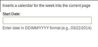

Open the properties file in the resources directory, examplemacro.properties, and add the following properties to the file:
1 2com.example.plugins.tutorial.confluence.examplemacro.examplemacro.param.date.label=Start Date: com.example.plugins.tutorial.confluence.examplemacro.examplemacro.param.date.desc=Enter date in DD/MM/YYYY format (e.g., 03/22/2014)
These will provide the label and description for the parameter in the macro browser, as shown here:

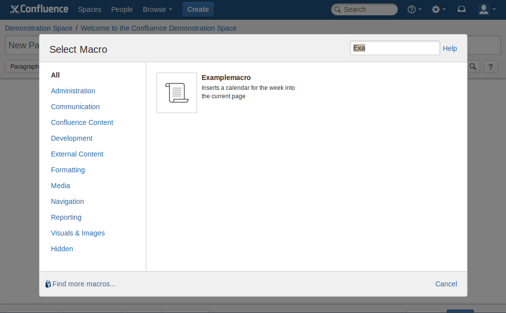

Create a new page in the Demonstration Space by clicking the Create button from the header.
In the edit page screen, click Insert > Other Macros.
Browsing to the macro in the Select Macro dialog. You can do so quickly by typing the first few letters of the macro name, such as Exa.
Select the macro and insert it into your page.
As you saw in the preview pane and on the page after saving your changes, so far the macro generates our placeholder text, "Only a test". We'll make it do more next.

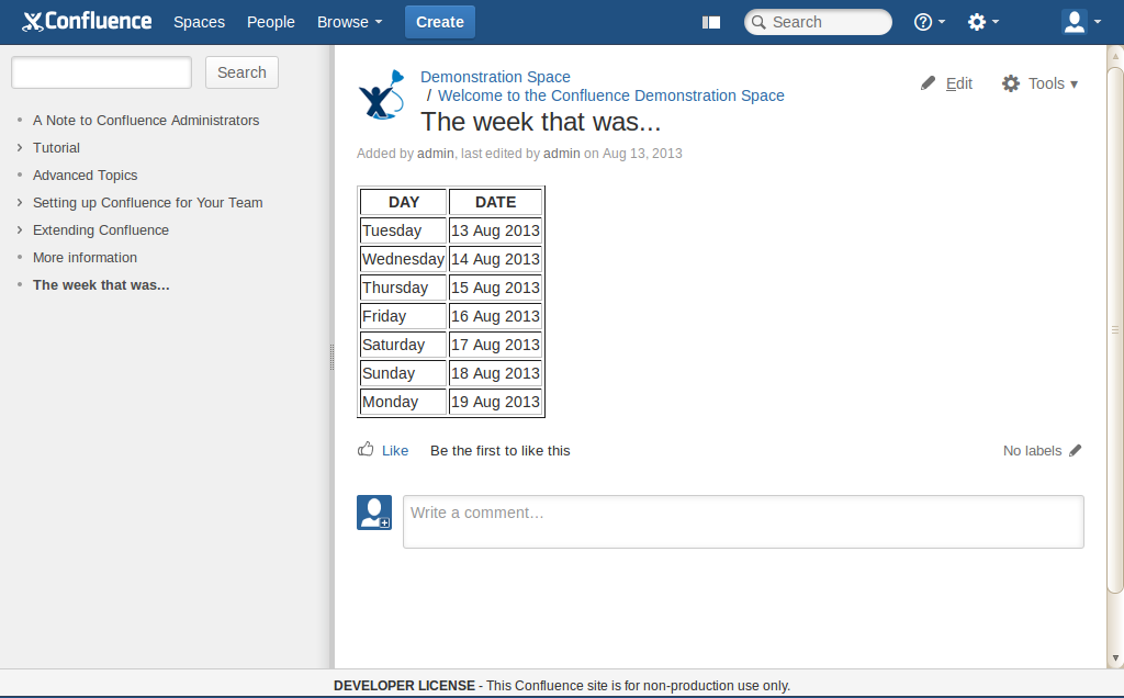

We're ready to try the macro again.
To see your new macro in action:
Congratulations, that's it
