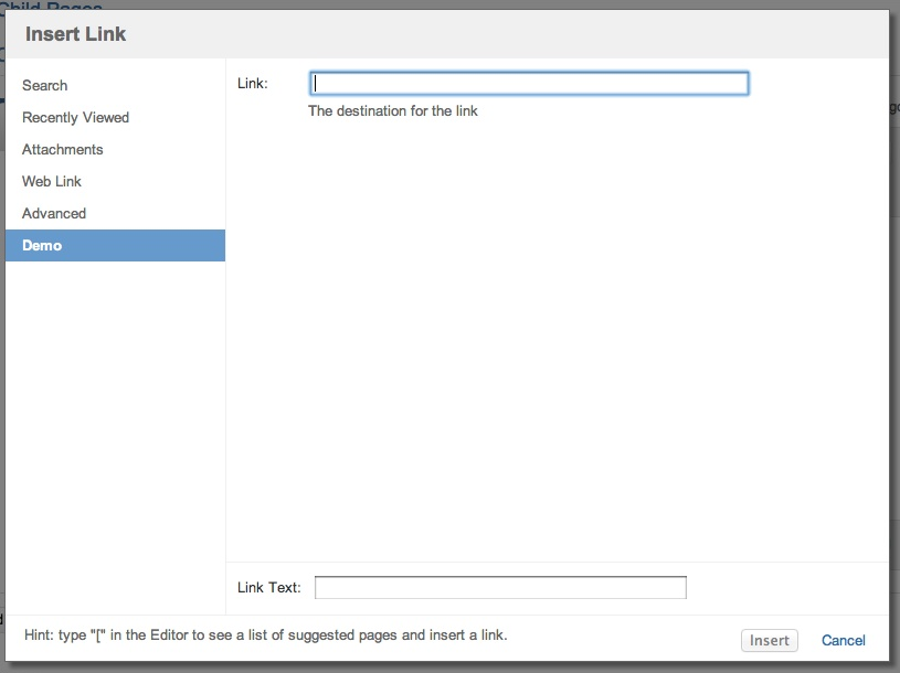

Overview of the tutorial
This tutorial shows you how you can add a panel to the Insert Link dialog in Confluence. The plugin you will create inserts a new tab called Demo in the dialog. When you click the Demo tab, the Demo panel appears with a single text box:
Our plugin simply converts text entered in the field into an HTML link. This is a simple plugin, but provides a starting point for the more advanced link dialog customizations you might like to add to Confluence.
To create this plugin, you will create a Confluence plugin consisting of the following components:
When you have finished, all these components will be packaged in a single JAR file.

Step 3. Create a Soy template for the custom panel
The SDK generated some resource files for us. However, we'll keep the resource files associated with this plugin in a separate directory, just for clarity.
First, create the Soy template used to generate our Insert Link panel:
  1. Change to the following directory under the new project home: src/main/resources/
  2. Create a new directory called insert-link. This is where we'll keep the resource files specific for our plugin.
  3. In the new directory, create a file named demo-panel.soy.
  4. Add the following content to the file:
1
2
{namespace Confluence.Templates.LinkBrowser}
 * The contents of the panel.
{template .demoPanel}
    <div class="input-field">
        <label for="demo-panel-destination">{getText('link.browser.demo.link.label')}:</label>
        <input type="text" tabindex="0" class="text" id="demo-panel-destination" name="destination" size="60">
    </div>
    <div class="description">{getText('link.browser.demo.link.desc')}</div>
{/template}
The namespace must be Confluence.Templates.LinkBrowser, as shown here. The name of the template, demoPanel, must be the key of your panel (as specified in the JavaScript file below) with the suffix -Panel. In this case, our panel's key is demo, so the template name is demoPanel.
The template should contain the markup you want to appear in the body of the link dialog. In this case, we have a label with an i18n key of link.browser.demo.link.label, a text box with the name destination, and some description text with an i18n key of link.browser.demo.link.desc.

Step 5. Create CSS and i18n files to provide styling and text for the panel
  1. Create a file named confluence-insert-link-demo-plugin.css in the src/main/resources/insert-link/ directory.
  2. Insert the following CSS code into the file:
    1
    2
    .demo-panel label {
        width: 54px;
    .demo-panel .description {
        margin-left: 64px;
  3. Open src/main/resources/confluence-insert-link-demo-plugin.properties for editing.
  4. Add the following properties to the file:
    1
    2
    link.browser.tab.name.demo=Demo
    link.browser.demo.link.label=Link
    link.browser.demo.link.desc=The destination for the link
The CSS and properties files will provide the styling and text for our panel.

Step 7. Try it out
Now start up Confluence and try out your plugin:
  1. Make sure you have saved all your code changes to this point.
  2. Open a terminal window and navigate to the plugin root folder (where the pom.xml file is).
  3. Run the following command:
    1
    2
    atlas-run
    This command builds your plugin code, starts a Confluence instance, and installs your plugin in it. This may take several seconds. When the process has finished, you will see many status lines on your screen concluding with something like the following:
    1
    2
    [INFO] confluence started successfully in 119s at http://atlas-laptop:1990/confluence
    [INFO] Type CTRL-D to shutdown gracefully
    [INFO] Type CTRL-C to exit
  4. From your browser, open the Confluence URL indicated in the output.
  5. At the Confluence login screen, enter the username/password combination of admin and admin.
  6. Create a new page.
  7. In the edit pane for your page, click the link icon.
  8. Confirm that the Demo tab appears in the Insert Link dialog.  Also, make sure that the link insert pane appears with no errors.
Troubleshooting
If the Demo tab does not appear in the dialog, make sure you have the web-item correctly registered in atlassian-plugin.xml. Also make sure that you have installed the plugin in Confluence and it is enabled.
If the panel itself is not working properly, check for JavaScript errors in the debugging console in your browser. Firebug or the WebKit inspector may help you debug your code and track down the problem.
Rate this page:
