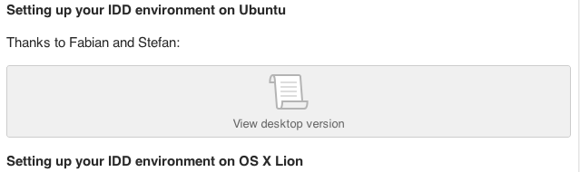

By default, Confluence Mobile does not render macros. Instead it displays a placeholder which, when tapped, loads the desktop version of the page.
With a little additional effort, you can modify an existing macro for display in the Confluence Mobile interface.
