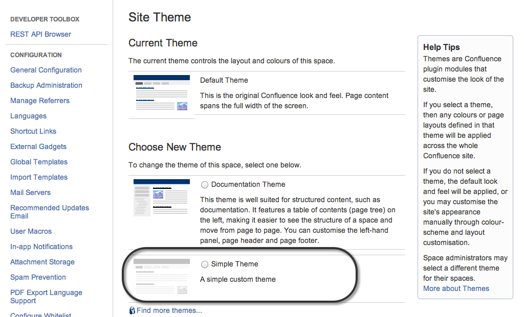

  6. In the left-hand sidebar, under Look & Feel, click Themes. The Site Theme page loads, with your custom-created "Simple Theme" listed as an option. Note the title and descriptive text match what you entered.
    The Themes page in Confluence
  7. Select the Simple Theme radio button, and then click Confirm.
    The page reloads, with no changes apparent: the changes you made don't effect the admin page.

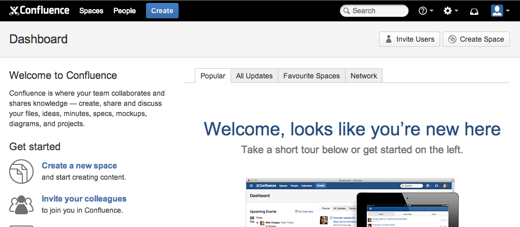

  8. To return to the main dashboard, click the Confluence logo in the upper-left corner.
    Your CSS is installed. All spaces, except for the admin console, will have this navigation color scheme now.
    Confluence looking sharp in black
