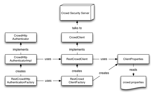

If you are using a dependency injection container which manages singleton instances, rather than using the RestCrowdClientFactory and RestCrowdHttpAuthenticationFactory to manage singletons, you can wire up the objects themselves as shown in the following diagram:
Please use EITHER dependency injection OR the factories. Using both will result in multiple instances being maintained throughout your application.
If you are using Spring for dependency injection, a convenient `applicationContext-CrowdRestClient.xml` has been provided in the `crowd-integration-client-rest.jar`. This Spring configuration file wires up the `CrowdHttpAuthenticator` and `CrowdClient` factory as beans named `crowdHttpAuthenticator` and `crowdClient` respectively.
