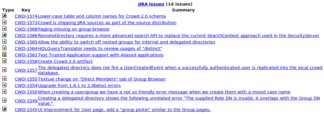

Now the Jira Issues Macro is able to render itself differently in display versus feed modes:
