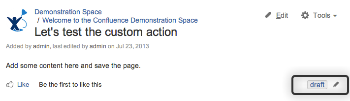

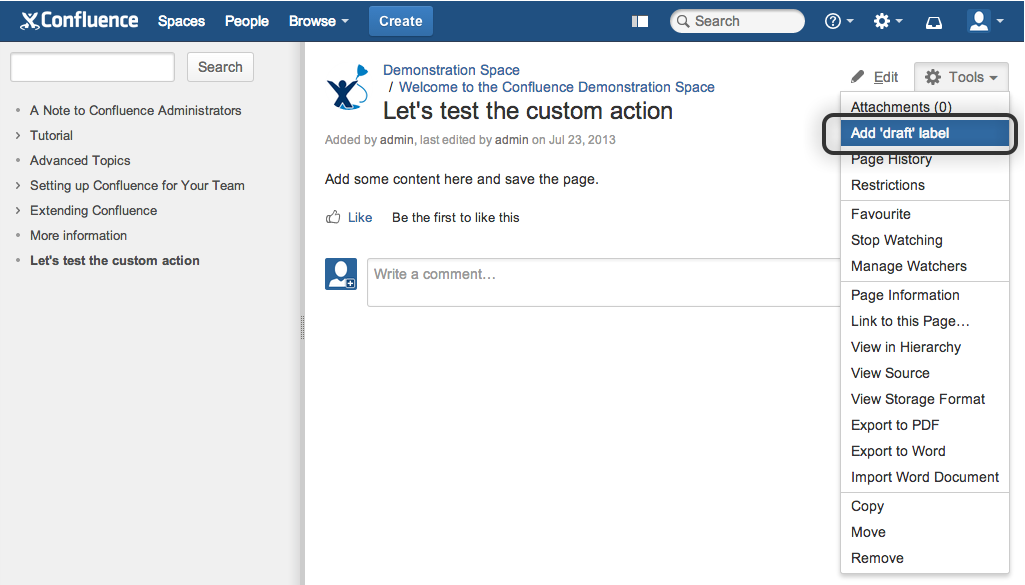

Tutorial overview
This tutorial shows you how to create a plugin to add a custom action to Confluence. The custom action adds a "draft" label to a Confluence page accessible from the Tools drop-down menu.
Finished custom action in Tools menu

    This section defines the <label> users will see in the Tools menu, and when the custom action is accessible ( system.content.action/primary). There are four sections in the Tools menu: primary, marker, secondary, and modify. Designating your plugin's location as primary will place it at the top of the menu.

  4. In your browser, open your local Confluence instance and log in with admin / admin.
  5. Click Create.
  6. In the dialog box, choose Blank Page, and then click Create.
  7. Add some content, and then click Save.
  8. Click Tools > Add 'draft' label.
  9. Verify that the 'draft' label is applied.
    Confirm the label was applied
