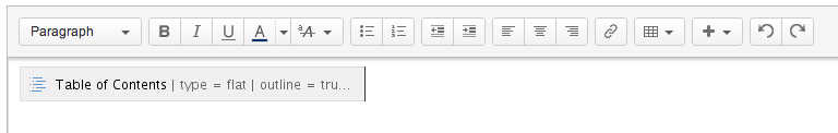

By default as many parameters as can fit will be displayed in the placeholder, as shown here:

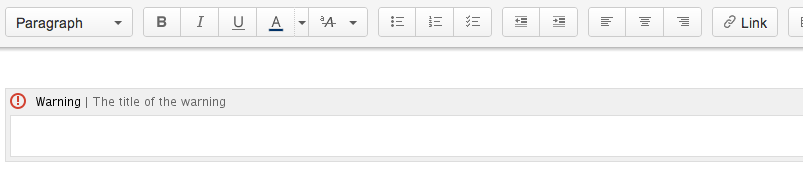

Let's assume an author adds the Warning macro to a page, and gives it a title of 'The title of the warning'. The above configuration leads to a placeholder as shown here:
