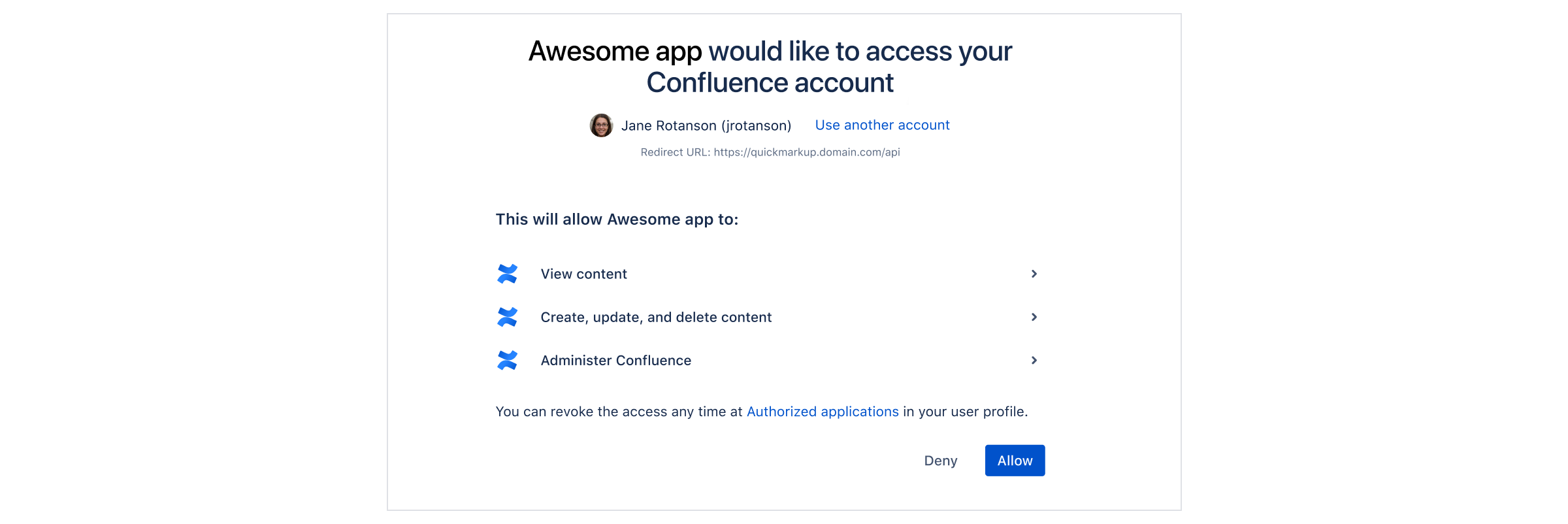

This is the consent screen that asks the user to approve the application’s request to access their account with the scopes specified in scope. The user is then redirected to the URL specified in redirect_uri. The redirect includes the authorization code, like in the following example:
1
2
https://atlassian.example.com/plugins/servlet/oauth2/consent?client_id=CLIENT_ID&redirect_uri=REDIRECT_URI&response_type=code&scope=SCOPE&state=STATE&code_challenge_method=CODE_CHALLENGE_METHOD&code_challenge=CODE_CHALLENGE
Authorization prompt
