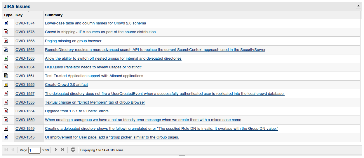

For Confluence 2.10 (remember that?), we converted the display of the Jira Issues Macro from using a static HTML table to using a table infused with jQuery goodness. Now we could add features that wouldn't have been possible without JavaScript, like the ability to sort issues in the page without even reloading. That was pretty cool, but it also meant we had a new problem to deal with: macros can be rendered in places that can't render JavaScript, such as in a feed reader or an email notification. In those cases, our beautifully redesigned macro would look something like a puddle of goo.
We thought about how to get around this new problem, and decided the best approach would be to make it possible for macros to find out if they are being rendered in an email or a feed, so they can display themselves appropriately. It was already possible for macros to find out if they are being rendered in a PDF document or several other contexts. In Confluence 2.10, we made it possible for macros to find out that they were being displayed in an email or feed, an addition to the previously defined contexts. Previously, macros being viewed in an email or feed reader would have just had the render type "display", which is the default.

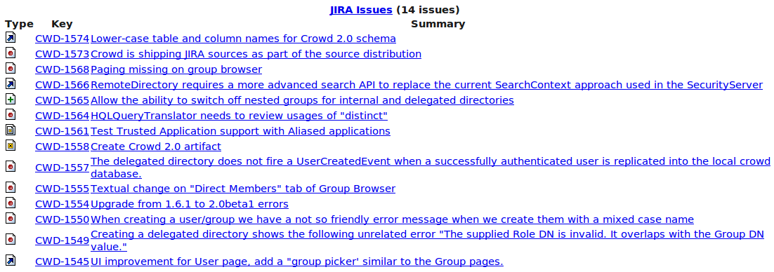

Now the Jira Issues Macro is able to render itself differently in display versus feed modes:
