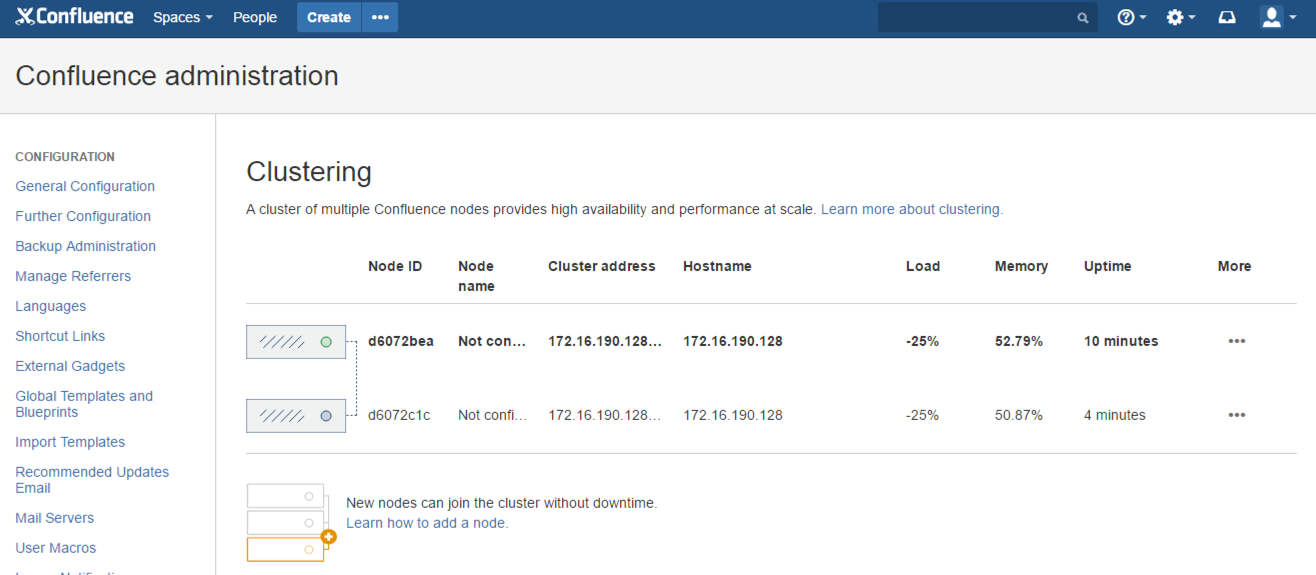

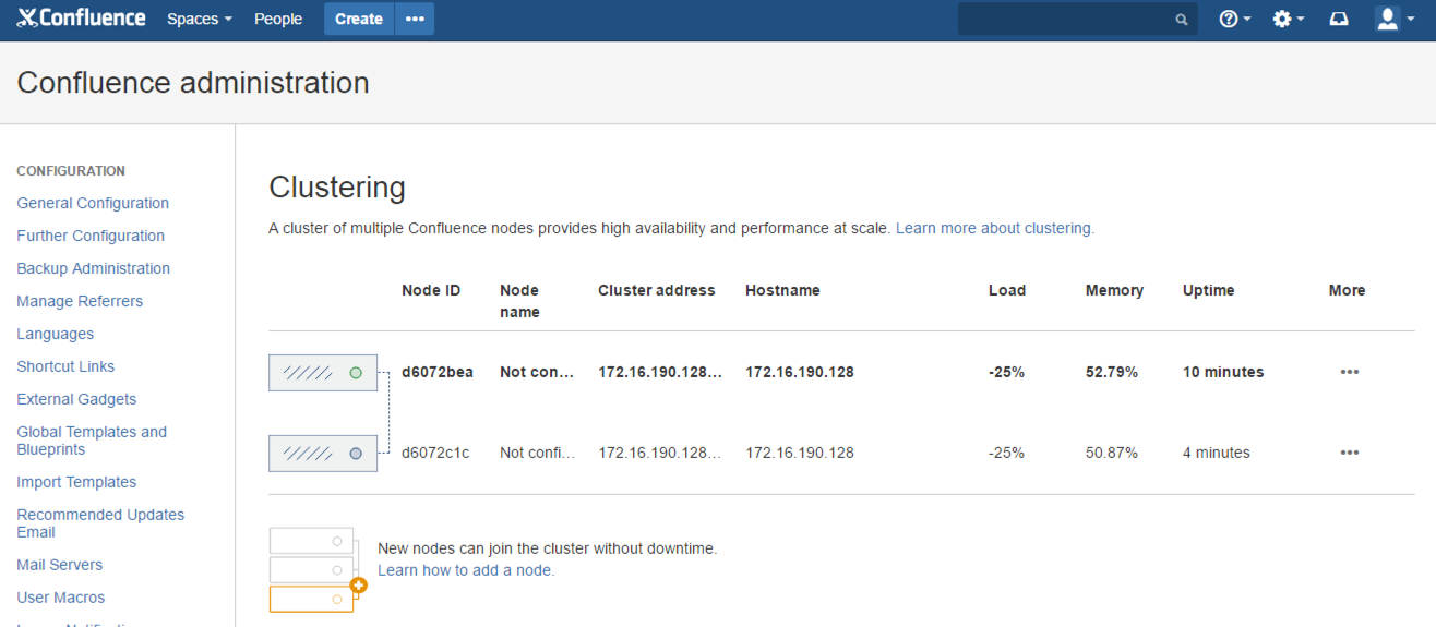

  3. On either node, go to General Configuration > Clustering to check your cluster is running.  You should see both nodes reported, similar to this:
