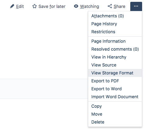

  7. The storage format of the page opens in a new browser window. It should look like:
