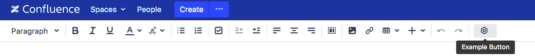

Step 5. Run your plugin
At this point, you can run Confluence and test the plugin you have just created.
  1. To start a local Confluence instance, run the following command:
    1
    2
    atlas-run
    This command takes a minute or so to run. It builds your plugin code, starts a Confluence instance, and installs your plugin. When the process is finished, you see many status lines on your screen concluding with something like the following:
    1
    2
    3
    4
    5
    6
    [INFO] [talledLocalContainer] INFO: Starting Coyote HTTP/1.1 on http-1990
    [INFO] [talledLocalContainer] Tomcat 8.x started on port [1990]
    [INFO] confluence started successfully in 132s at http://localhost:1990/confluence
    [INFO] Type Ctrl-D to shutdown gracefully
    [INFO] Type Ctrl-C to exit
    The output includes a URL for the Confluence instance.
  2. Log in as admin / admin.
    The Confluence Dashboard appears.
  3. To open the editor, click Create button.
  4. Your button appears the last in the toolbar:
