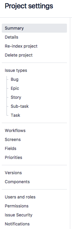

The atl.jira.proj.config location defines web sections (for groups of tabs) and web items (for individual tabs within a group) that are available when viewing a project's configuration in Jira's administration area.
You can add new web items to predefined web sections (that is, groups of tabs) or add new sections along with their own items.
Adding new items to existing web sections
To add your own web item to an existing web section (that is, groups of tabs) of Jira project configuration in the administration area, your web item must include a section attribute with the value "atl.jira.proj.config/existing_web_section_name", where existing_web_section_name is the existing group of tabs to which the web item will be added.
The following table lists these existing web sections (by existing_web_section_name) and the existing web items associated with these web sections. The weight attribute values associated with each web section and item are indicated in brackets.
For more information about the purpose of this attribute, see Customizing the positions of items and sections.
Group of tabs existing_web_section_name
Web items associated with this group of tabs
projectgroup1 (10)
Summary (10)
Details (11)
Re-index project (13)
Delete project (15)
projectgroup2 (20)
Workflows (20)
Screens (30)
Fields (40)
Priorities (50)
projectgroup3 (30)
Versions (10)
Components (20)
projectgroup4 (40)
Users and roles (15)
Permissions (20)
Issue Security (30)
Notifications (40)
For example, to add a web item module that defines a new item in the projectgroup3 section, which appears between the existing Versions and Components web items, your web item module should contain the following:
