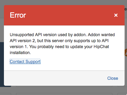

Minimum Server Version
It is not possible to install an addon into a HipChat server instance if the requested server API version is not satisfied. If someone attempts to install an addon into an unsupported HipChat server version they will see an error:

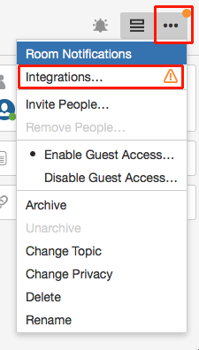

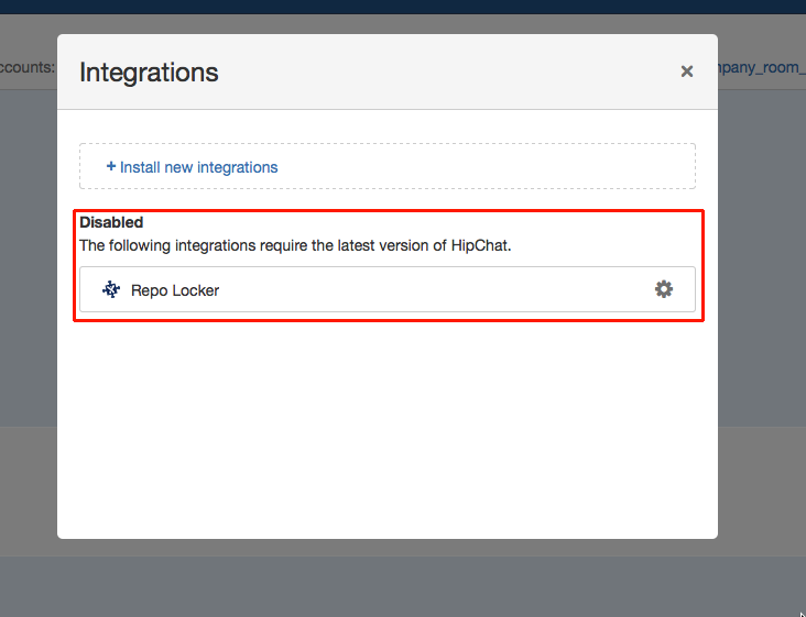

Minimum Client Version
Your addon will not be loaded within the HipChat client if the client API version you requested is not satisfied. The addon will be marked as disabled within the integrations screen, and markers added to the room menu to show some addons have been disabled.
