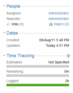

Right Side of the 'View Issue' Page Location
Available in Jira 4.4 and later.
The atl.jira.view.issue.right.context location defines web panels for the right hand side of the 'View Issue' page.
Adding Custom Panels
To add your own web panel to the summary tab location of Jira's project configuration administration, your web panel must include a location attribute whose value is "atl.jira.view.issue.right.context".
For example:
1
2
3
4
5
6
<web-panel ... location="atl.jira.view.issue.right.context" ...>
        <label key="my-new-panel.title"/>
</web-panel>
Panel Headings
If you wish to create a 'panel label' (i.e. the collapsible heading which appears at the top of the panel), define a <label> element with a key attribute whose value defines a unique property (i.e. my-new-panel.title based on the example above). The string value of this unique property (defined in your plugin's i18n.properties file) will be shown in bold text at the top of your section.
If you do not wish a heading to appear at the top of the panel, include the following child element in your <web-panel> module:
1
2
<param name="headless">true</param>
Customising the Positions of Panels
To customise the position of your own web panels in this location, add a weight attribute to your <web-panel> and adjust its value with respect to Jira's existing web panels. Lower weight values result in these panels appearing higher up the right hand side of the 'View Issue' page.
Source File
To find the values of Jira's existing web panels for the atl.jira.view.issue.right.context location, view the following file in Jira's source archive:
<source-installation-directory>/jira-project/jira-components/jira-plugins/jira-view-issue-plugin/src/main/resources/atlassian-plugin.xml
