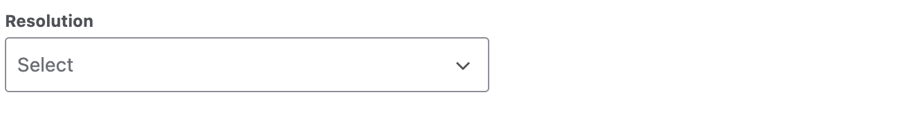

Resolution
type: resolution
setValue signature
Use null to unset the value.
1
2
setValue(id: string | null): FieldAPI
getValue signature
1
2
getValue(): ResolutionField
Resolution field shape
1
2
3
4
5
  value: string,
} | null
Reference screenshot

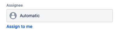

assignee
type: assignee
setValue signature
1
2
setValue(accountId: string | null): FieldAPI
getValue signature
1
2
getValue(): AssigneeField
Assignee field shape
1
2
3
4
null | {
    accountId: string,
Known limitation
The number of unique accountIds that can be set via the setValue method can't be greater than 90 per one batched update.
This means that all calls to setValue for user-based fields performed in a single onInit or onChange callback are counted against this limit.

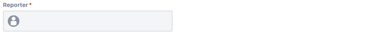

reporter
type: reporter
setValue signature
1
2
getValue signature
1
2
getValue(): ReporterField
reporter field shape
1
2
null | {  accountId: string }
Known limitation
Reference screenshots

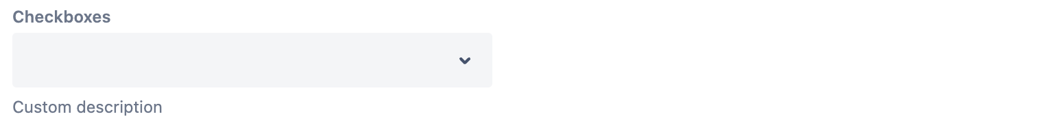

checkboxes
type: com.atlassian.jira.plugin.system.customfieldtypes:multicheckboxes
setValue signature
Use [] to unset the value.
1
2
setValue(ids: string[]): FieldAPI
getValue signature
1
2
getValue(): MultiCheckboxesField
checkboxes field shape
1
2
3
4
5
6
7
8
9
10
11
12
        value: string,
        value: string,
Known limitation
In Issue view and Issue transition, you can only set up to 100 IDs per update using the setValue method.
This means that each supported field has its own limit of 100 IDs.

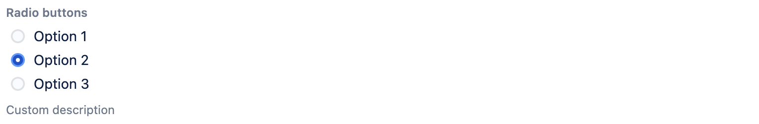

radio buttons
type: com.atlassian.jira.plugin.system.customfieldtypes:radiobuttons
setValue signature
1
2
getValue signature
1
2
getValue(): RadioButtonsField
radio buttons field shape
1
2
3
4
5
null | {
    value: string,

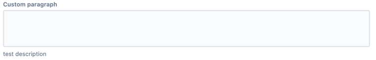

paragraph
type: com.atlassian.jira.plugin.system.customfieldtypes:textarea
setValue signature
1
2
setValue(value: ParagraphField): FieldAPI
getValue signature
1
2
getValue(): ParagraphField
paragraph field shape
1
2
3
4
5
6
7
8
9
string // Plain-text editor
type ADF = {
    version: 1,
    type: 'doc',
    content: Node[]
} // Rich-text editor (ADF format)
// https://developer.atlassian.com/cloud/jira/platform/apis/document/structure/

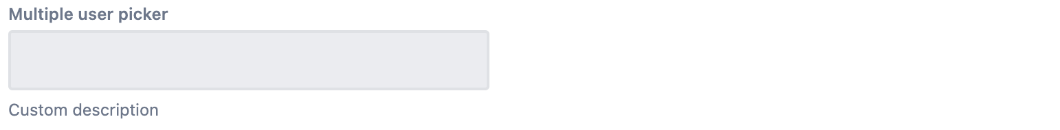

multi user picker
type: com.atlassian.jira.plugin.system.customfieldtypes:multiuserpicker
setValue signature
1
2
setValue(accountId: string[]): FieldAPI
getValue signature
1
2
getValue(): MultiUserPickerField
multi user picker field shape
1
2
3
4
5
6
7
8
9
10
        accountId: string,
        accountId: string,
Known limitation

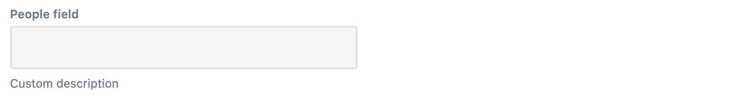

people
type: com.atlassian.jira.plugin.system.customfieldtypes:people
setValue signature
1
2
getValue signature
1
2
getValue(): PeopleField
people field shape
1
2
3
4
5
6
7
8
9
10
        accountId: string,
        accountId: string,
Known limitation

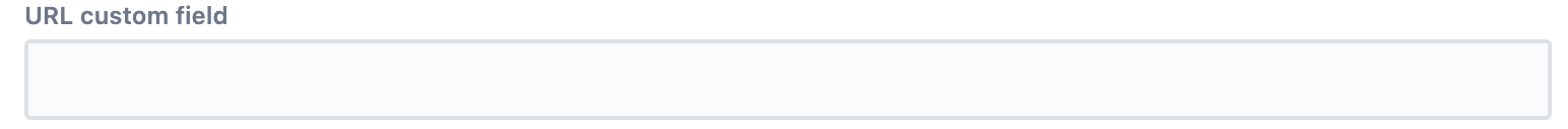

url
type: com.atlassian.jira.plugin.system.customfieldtypes:url
setValue signature
1
2
setValue(url: string): FieldAPI
getValue signature
1
2
getValue(): UrlField
url field shape
1
2
string

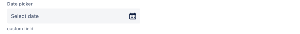

date picker
type: com.atlassian.jira.plugin.system.customfieldtypes:datepicker
setValue signature
The provided string must be in the yyyy-MM-dd date format.
1
2
setValue(date: string | null): FieldAPI
getValue signature
1
2
getValue(): DatePickerField
date picker field shape
1
2
string | null

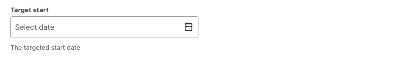

target start
type: com.atlassian.jpo:jpo-custom-field-baseline-start
setValue signature
1
2
getValue signature
1
2
1
2
string | null

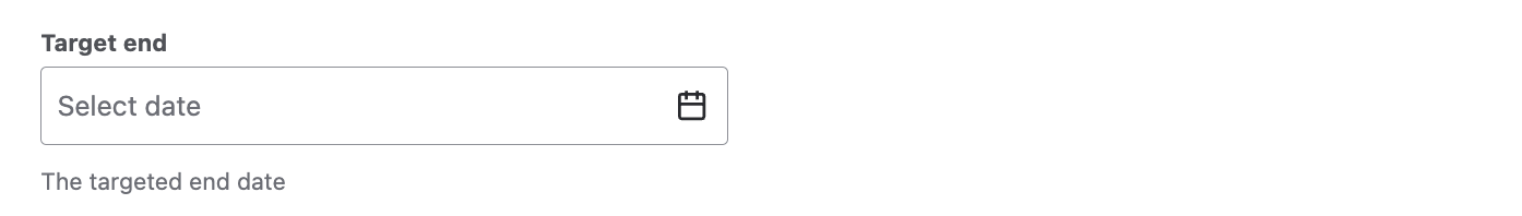

target end
type: com.atlassian.jpo:jpo-custom-field-baseline-end
setValue signature
1
2
getValue signature
1
2
1
2
string | null

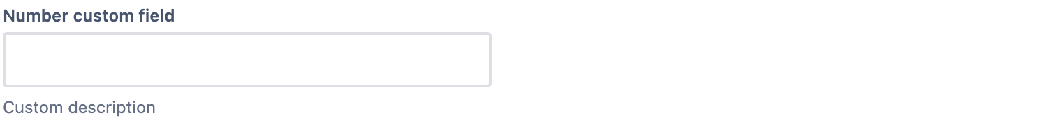

number
type: com.atlassian.jira.plugin.system.customfieldtypes:float
setValue signature
1
2
setValue(value: number | null): FieldAPI
getValue signature
1
2
getValue(): NumberField
number custom field shape
1
2
number | null

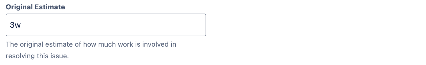

original estimate
type: timeoriginalestimate
setValue signature
1
2
getValue signature
1
2
getValue(): OriginalEstimateField
original estimate field shape
1
2
number | null
