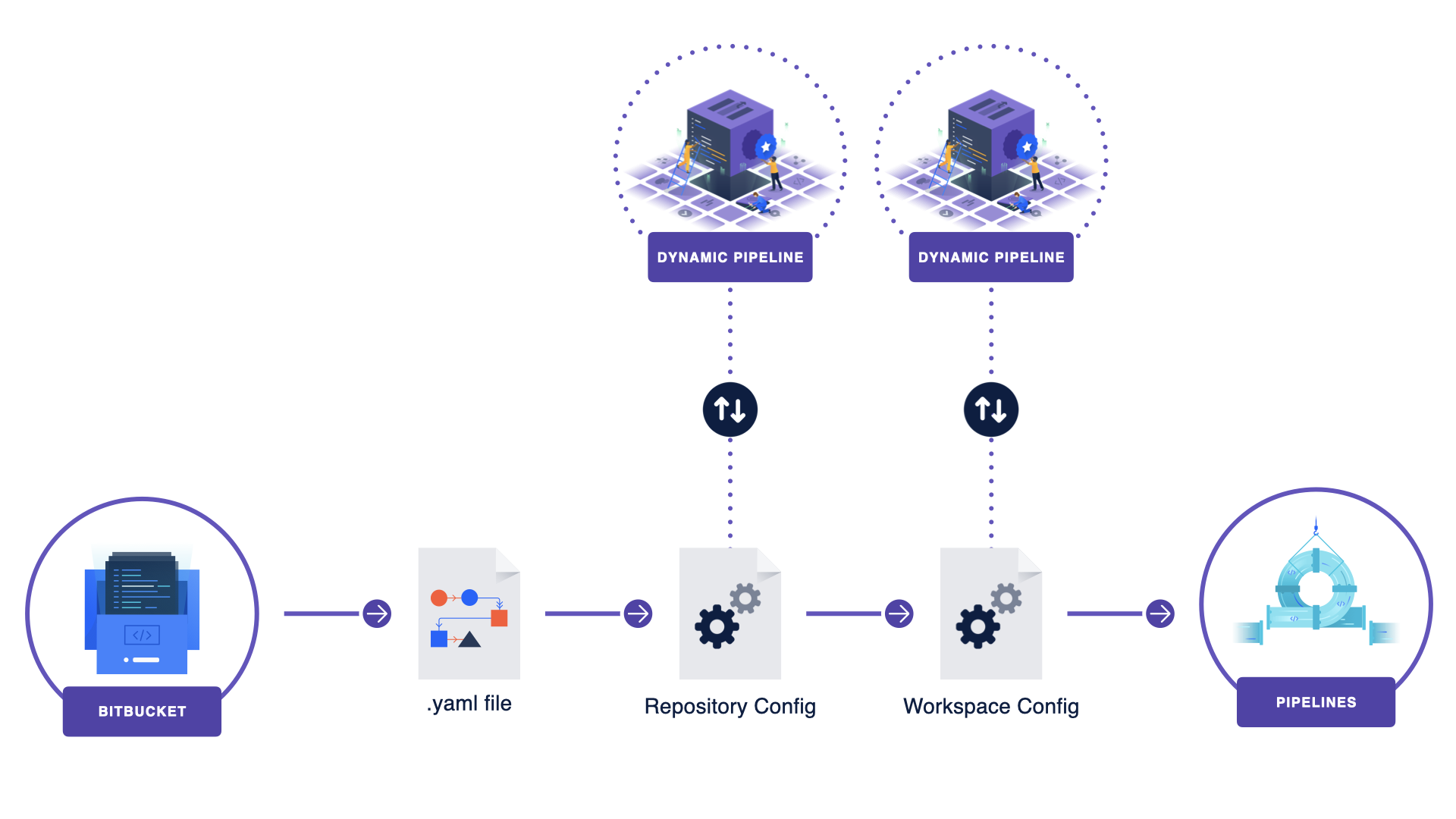

For any given Workspace, there can be many bitbucket:dynamicPipelinesProvider modules installed. However, each resource within that workspace can only have a single dynamicPipelinesProvider selected to execute for that resource.
For example:
  • You may have four separate repositories within a workspace - Repos A, B, C, & D
    • Those repositories may all have unique bitbucket:dynamicPipelinesProvider modules configured for each of them (Providers A, B, C, & D), or they may share/reuse providers in any configuration the user wants.
    • However, each individual repository can only have a single bitbucket:dynamicPipelinesProvider module configured for it.
  • In addition, a bitbucket:dynamicPipelinesProvider module can also be configured against other resources above those repositories in the hierarchy (e.g. the parent workspace).
    • Just like at the repository level, only a single bitbucket:dynamicPipelinesProvider can be configured for those resources (e.g. the parent workspace).
  • At runtime, these bitbucket:dynamicPipelinesProvider modules at different levels of the hierarchy create a chain, all of which will be executed for the respective pipeline run.
    • This allows multiple levels of dynamic execution to occur, in a specific order, one at each level of the hierarchy.
Each Dynamic Pipelines provider acts as a transforming function of the pipeline configuration: it takes a valid pipeline configuration along with pipeline metadata as input, and generates a valid pipeline configuration as output. This “Pipeline-In|Pipeline-Out” design is what enables multiple providers to be chained together up the hierarchy.
This chain will always be executed in a “bottom up” order, starting with the static .yml configuration stored in the repository, then the repository level bitbucket:dynamicPipelinesProvider and finally, the workspace level bitbucket:dynamicPipelinesProvider. This ensures that policies and rules put in place “higher” in the hierarchy are able to take precedence over ones implemented “lower” in the hierarchy.
Dynamic Pipeline execution hierarchy
The output of this chain is the final pipeline workflow which is then consumed by Bitbucket Pipelines to generate and run a pipeline using that definition.

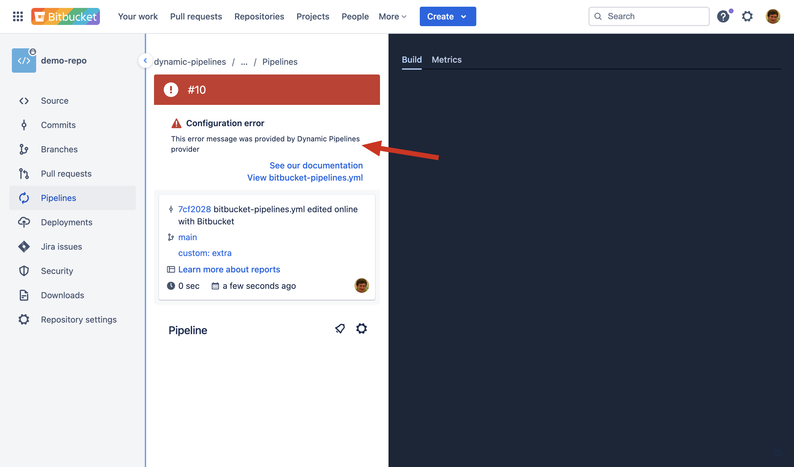

If any exceptions are thrown when executing the Dynamic Pipelines provider logic, the result will be treated as a failure. Bitbucket Pipelines may retry the request to the Dynamic Pipelines provider in such case.

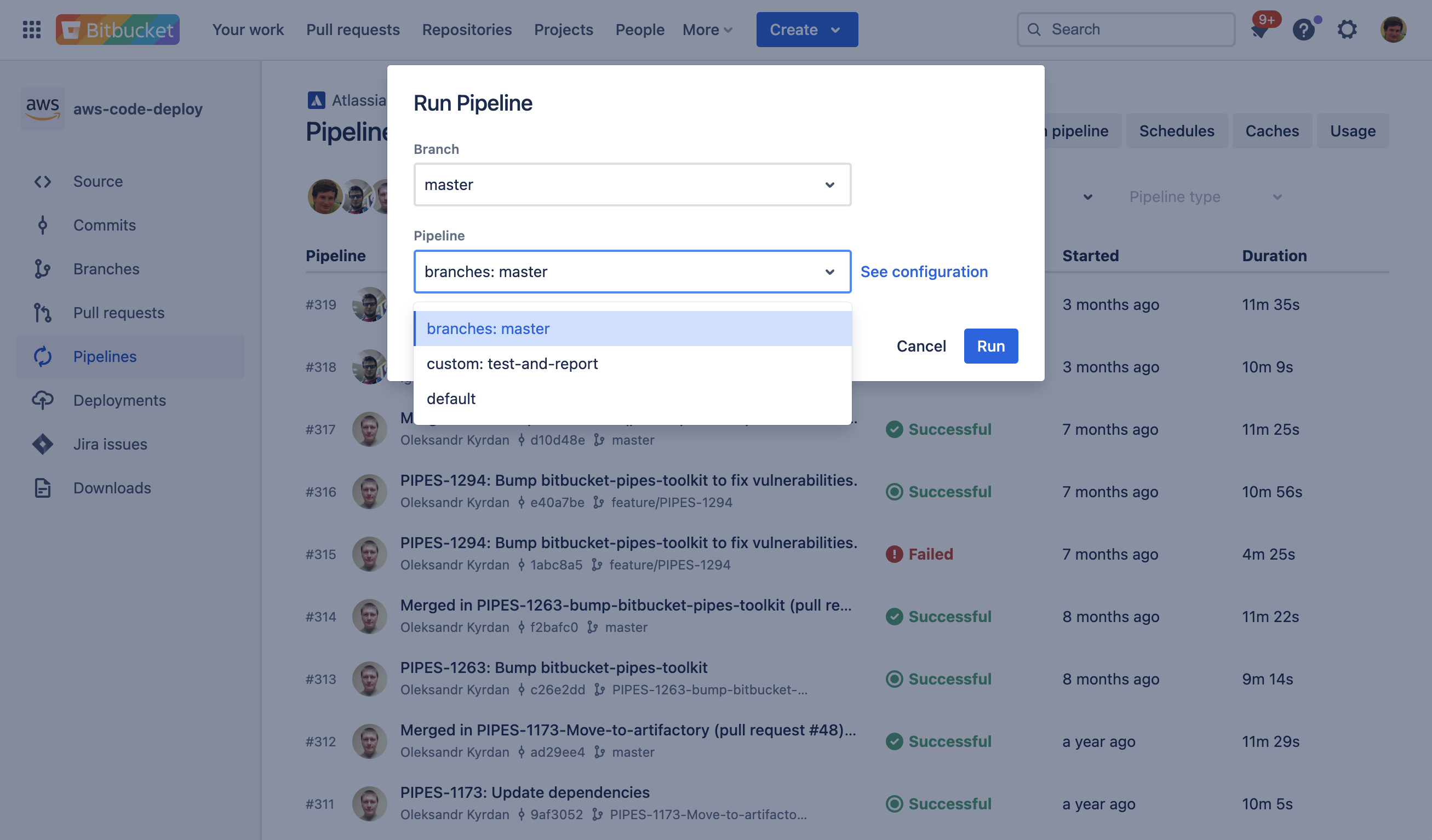

Get pipeline definitions
This scenario is triggered, for example, when user opens the Run pipeline dialog in the UI and selects a branch.
The list of pipeline definitions in the Run pipeline dialog
The Dynamic Pipelines provider is expected to return all pipeline definitions applicable for the provided context. From this set of results, the user can then select a definition to run.

ProviderError
If provided, the error message will be shown to the user in the UI on the pipeline result screen.
The custom error message returned by the Dynamic Pipelines provider
ParameterTypeDescription
keystringThe identifier of the Dynamic Pipelines provider error.
messagestringThe message describing the error which can be shown to the user in the UI.

A response with an error:
1
2
  "error": {
    "key": "provider.error.example",
    "message": "This error message was provided by Dynamic Pipelines provider"
