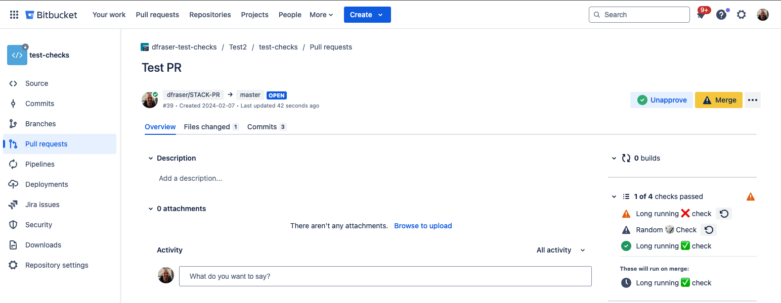

Example of a bitbucket:mergeCheck in a pull request
Each module will be treated as its own check and have independent results. A check must pass for a pull request to be merged if it is configured to be Required in either the Workspace, Project or Repository Settings by an administrator. If the check is configured as Not required, then it is informational only and will not block pull request merge. The check results are rendered on the pull request page, which will help to guide the user towards the changes needed for the check to pass.
If the same check is configured at multiple levels (for example, in Workspace and Repository settings), it will run once for each level. Results are still treated independently, so if the check was configured as Required at one level, and it fails, the pull request merge will be blocked, regardless of whether or not it was configured as Not required at another level.

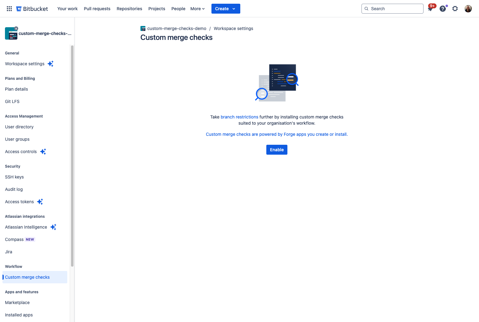

Once a Forge app with a bitbucket:mergeCheck module has been installed into a Bitbucket workspace, the workspace admin must enable the Custom merge checks feature in the workspace settings before they can be configured.
Enable the custom merge check feature in your workspace settings
After this, the check can be enabled by an appropriate admin at either the repository, project or workspace level. The admin is also able to specify the PR target branch pattern that the check should be run against and whether or not the check should be Required.

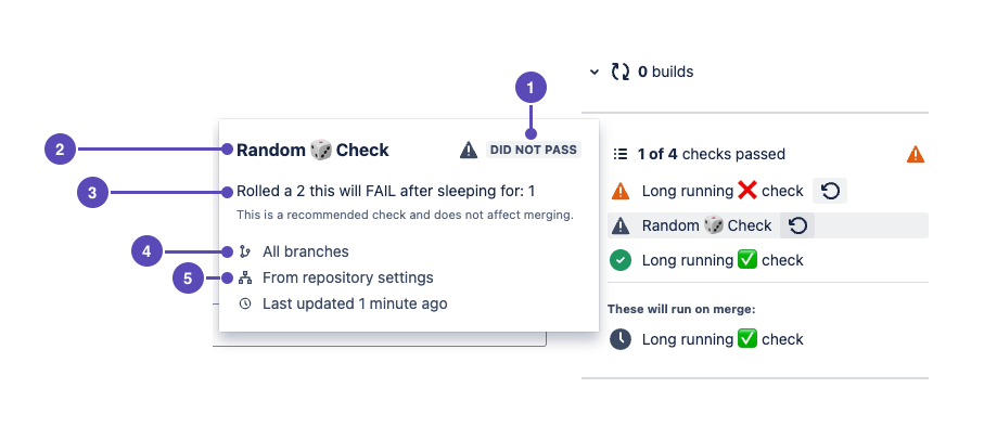

Merge check results in the Bitbucket UI
Example of a bitbucket:mergeCheck in a pull request, annotated with identifiers
  1. Merge check result: derived from response payload success field.
  2. Merge check name: derived from the module name field.
  3. Merge check message: derived from the response payload message field.
  4. Configured branch: the branch(es) the check has been configured to run against by the administrator.
  5. Configured resource: the resource level the check has been configured at by the administrator.
