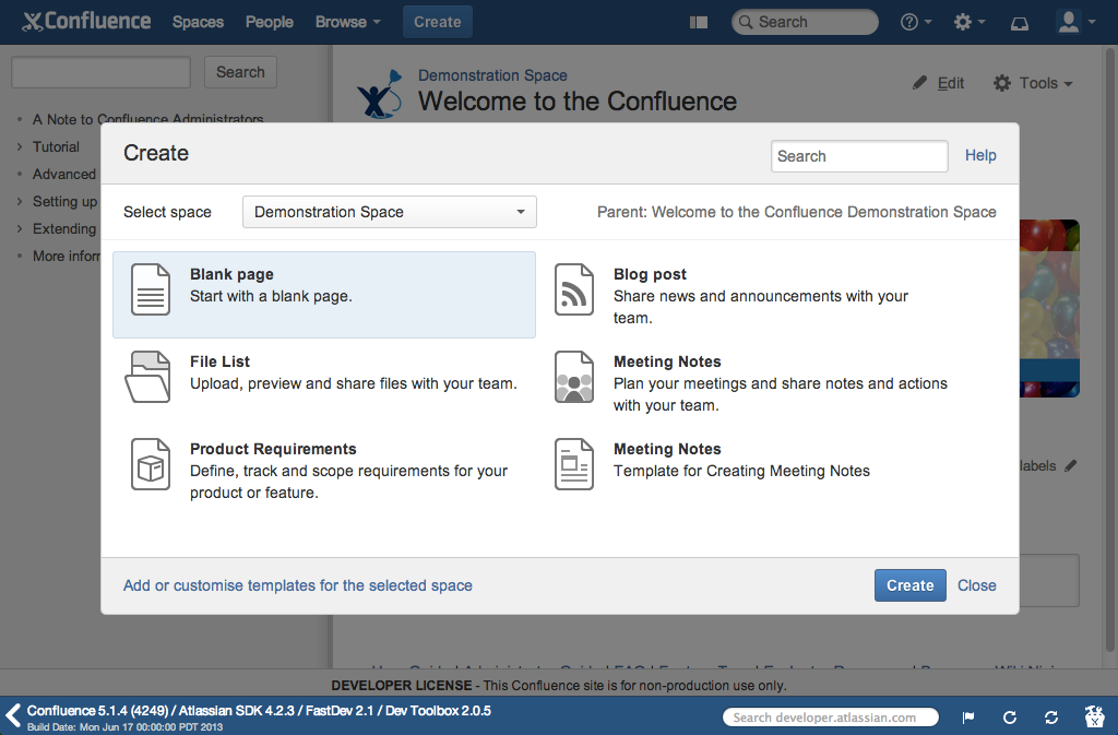

  1. In the Confluence header click Spaces > Demonstration Space.
  2. At the top of the page, click Create The system displays the Create dialog. It is this dialog you customize by adding your own blueprint to it.
  3. Click the Blank page item, and then click the Create button.
    The system puts you in a new page.

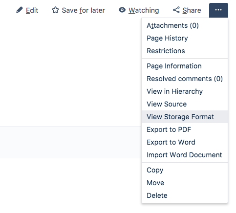

  7. The storage format of the page opens in a new browser window. It should look like:

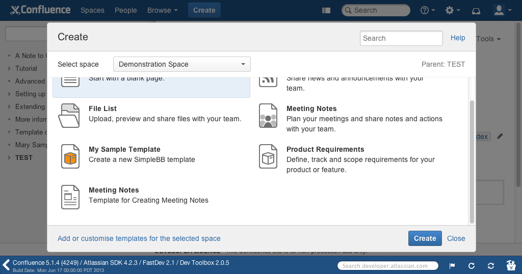

  2. Make sure you are still in the Demonstration Space.
  3. Click Create. The Create dialog appears and now contains your blueprint entry.
  4. Click the My Sample Template option.
    The system creates a new page using your template.
