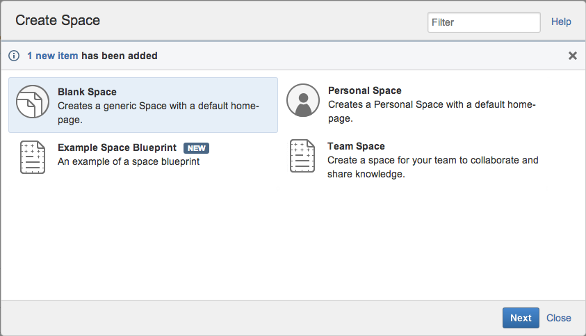

Step 2. Add your space blueprint definition
In this step, you will define your space blueprint and have a simple create space dialog wizard.
  1. To create a web item for the create space dialog, in the src/main/resources/atlassian-plugin.xml file, add the following:
    1
    2
    3
    4
    5
    6
    <web-item key='example-space-blueprint-item' i18n-name-key='confluence.blueprints.space.example.name'
              section='system.create.space.dialog/content'>
        <description key='confluence.blueprints.space.example.description'/>
        <param name='blueprintKey' value='example-space-blueprint'/>
    </web-item>
    The section='system.create.space.dialog/content' attribute is what makes the dialog available in the create space pop-up window.

Step 5. Run your plugin
At this point, you have created a skeleton space blueprint plugin.
  1. To start a local Confluence instance, run the following command:
    1
    2
    atlas-run
  2. Log in to the instance as user admin using a password of admin.
  3. Click SpacesCreate Space in the header, and then select your space blueprint.  It should take you through a wizard with a basic space form to create a space and see your home page with a children macro pre populated.
