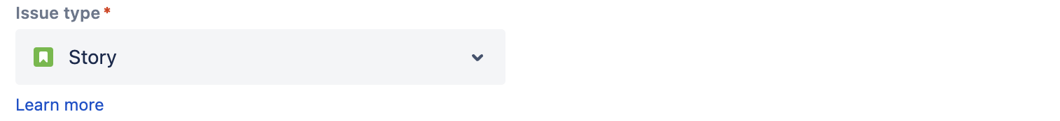

issue type
type: issuetype
setValue signature
Warning
The execution of the setValue method will initiate a UIM context change in Global issue create (GIC). Issue type is a part of the UIM invocation context. Changing the issue type with setValue changes that context.
UI modifications won’t be applied to an issue type field that’s out of the UIM app invocation context.
Note that issue types have different UIM app invocation contexts, so UIM functionality may not be applied the same way, in particular when it comes to setting visibility of options.
1
2
setValue(id: string): FieldAPI
getValue signature
1
2
getValue(): IssueTypeField
issue type field shape
1
2
Reference screenshots

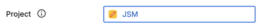

project picker
type: com.atlassian.jira.plugin.system.customfieldtypes:project
setValue signature
Special values
Use null to unset the value.
1
2
setValue(id: string | null): FieldAPI
getValue signature
1
2
getValue(): ProjectPickerField
Project Picker field shape
1
2
  projectId: string,   // '10002'
} | null

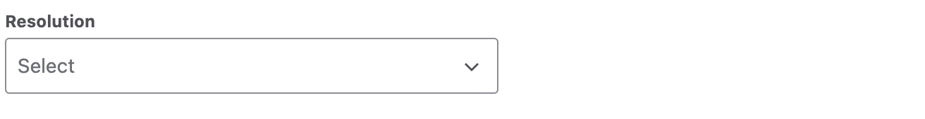

Resolution
type: resolution
setValue signature
Special values
1
2
getValue signature
1
2
getValue(): ResolutionField
Resolution field shape
1
2
  value: string,
} | null

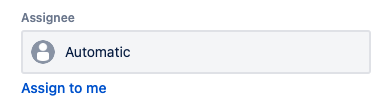

assignee
type: assignee
setValue signature
Special values
1
2
setValue(accountId: string | null): FieldAPI
getValue signature
1
2
getValue(): AssigneeField
Assignee field shape
1
2
null | {
    accountId: string,
Known limitation
The number of unique accountIds that can be set via the setValue method can't be greater than 90 per one batched update.
This means that all calls to setValue for user-based fields performed in a single onInit or onChange callback are counted against this limit.

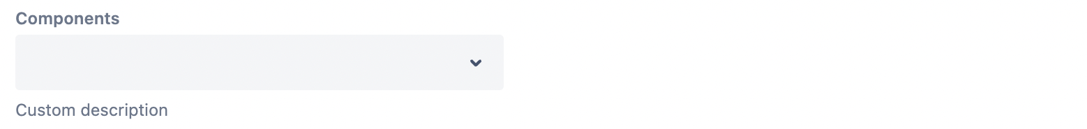

components
type: components
Field usage
setValue signature
Special values
Use [] to unset the value.
1
2
setValue(ids: string[]): FieldAPI
getValue signature
1
2
getValue(): ComponentsField
components field shape
1
2

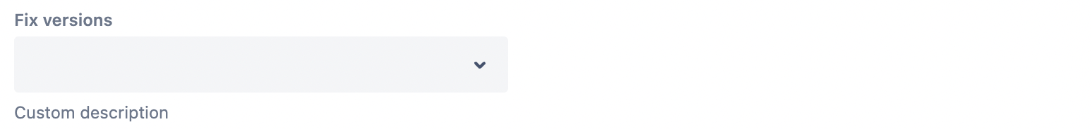

fix versions
type: fixVersions
setValue signature
Special values
1
2
getValue signature
1
2
getValue(): FixVersionsField
fix versions field shape
1
2
Known limitation
In Issue view and Issue transition, you can only set up to 100 IDs per update using the setValue method.
This means that each supported field has its own limit of 100 IDs.

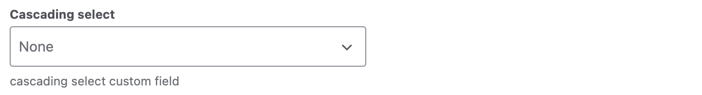

Cascading select
type: com.atlassian.jira.plugin.system.customfieldtypes:cascadingselect
setValue signature
Special values
1
2
setValue(value: {
    parentId: string;
    childId: string | null;
} | null): FieldAPI
getValue signature
1
2
getValue(): CascadingSelectField
cascading select field shape
1
2
null | {
    parent: { id: string; value: string };
    child: { id: string; value: string } | null;

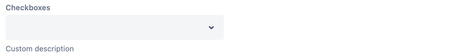

getValue(): MultiCheckboxesField
checkboxes field shape
1
2
        value: string,
        value: string,
Known limitation

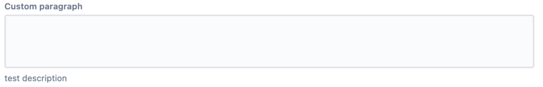

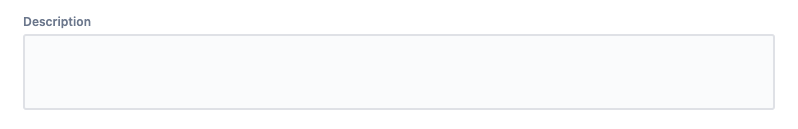

paragraph
type: com.atlassian.jira.plugin.system.customfieldtypes:textarea
setValue signature
1
2
setValue(value: ParagraphField): FieldAPI
getValue signature
1
2
getValue(): ParagraphField
paragraph field shape
1
2
string // Plain-text editor
type ADF = {
    version: 1,
    type: 'doc',
    content: Node[]
} // Rich-text editor (ADF format)
// https://developer.atlassian.com/cloud/jira/platform/apis/document/structure/

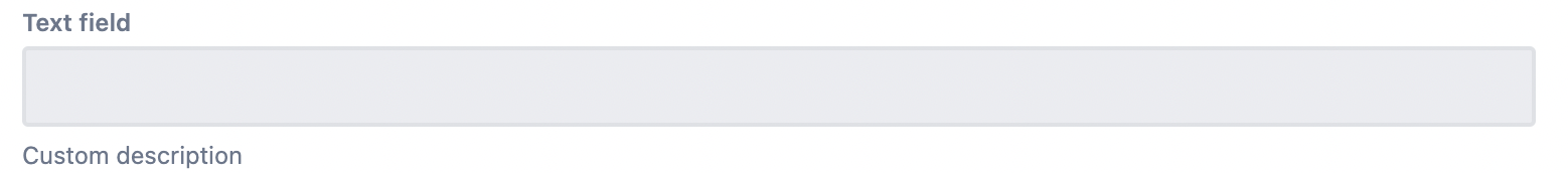

text field
type: com.atlassian.jira.plugin.system.customfieldtypes:textfield
setValue signature
1
2
setValue(value: TextField): FieldAPI
getValue signature
1
2
getValue(): TextField
text field shape
1
2

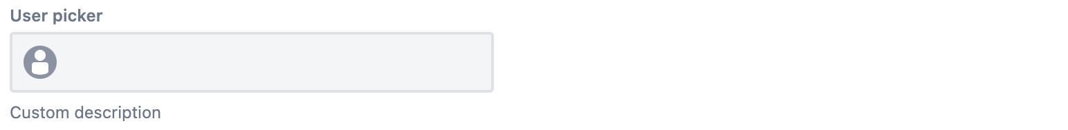

user picker
type: com.atlassian.jira.plugin.system.customfieldtypes:userpicker
setValue signature
Special values
1
2
getValue signature
1
2
getValue(): UserPickerField
user picker field shape
1
2
null | {
    accountId: string,
Known limitation

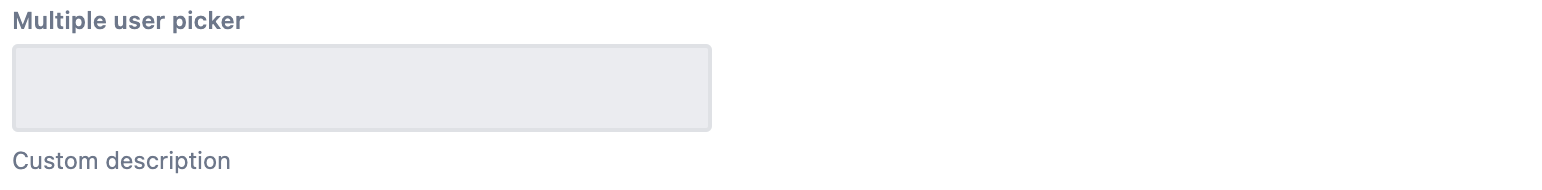

multi user picker
type: com.atlassian.jira.plugin.system.customfieldtypes:multiuserpicker
setValue signature
Special values
1
2
setValue(accountId: string[]): FieldAPI
getValue signature
1
2
getValue(): MultiUserPickerField
multi user picker field shape
1
2
        accountId: string,
        accountId: string,
Known limitation

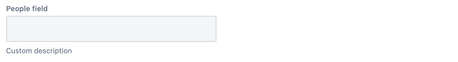

people
type: com.atlassian.jira.plugin.system.customfieldtypes:people
Field usage
Warning
The people field can be configured using either the single or multiple value field. In the case of a single value configuration, only the first value from the array provided via the setValue will be displayed in the field.
setValue signature
Special values
1
2
getValue signature
1
2
getValue(): PeopleField
people field shape
1
2
        accountId: string,
        accountId: string,
Known limitation

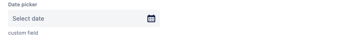

date picker
type: com.atlassian.jira.plugin.system.customfieldtypes:datepicker
setValue signature
Special values
Warning
The provided string must be in the yyyy-MM-dd date format.
1
2
setValue(date: string | null): FieldAPI
getValue signature
1
2
getValue(): DatePickerField
date picker field shape
1
2
string | null

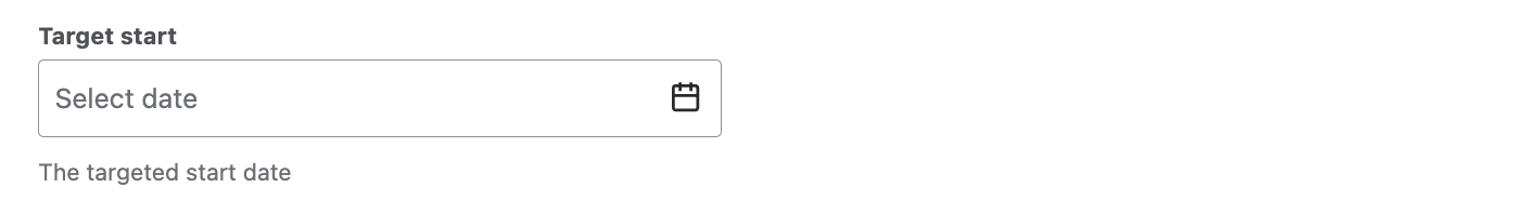

target start
type: com.atlassian.jpo:jpo-custom-field-baseline-start
setValue signature
Special values
Warning
1
2
getValue signature
1
2
1
2
string | null

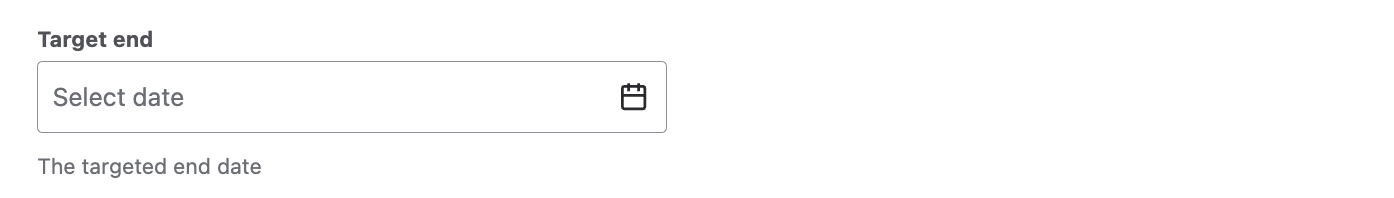

target end
type: com.atlassian.jpo:jpo-custom-field-baseline-end
setValue signature
Special values
Warning
1
2
getValue signature
1
2
1
2
string | null

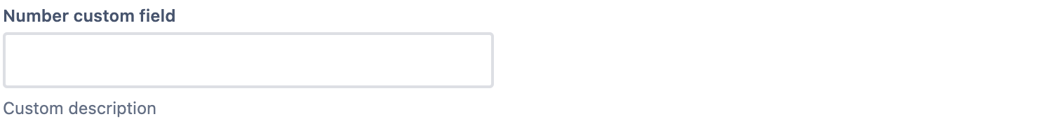

number
type: com.atlassian.jira.plugin.system.customfieldtypes:float
setValue signature
Special values
1
2
setValue(value: number | null): FieldAPI
getValue signature
1
2
getValue(): NumberField
number custom field shape
1
2
number | null

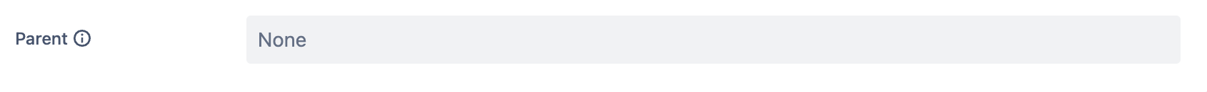

parent
type: parent
setValue signature
Special values
1
2
getValue signature
1
2
getValue(): ParentField
parent field shape
1
2
  key: string,
} | null

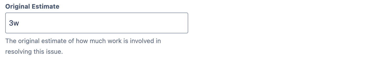

original estimate
type: timeoriginalestimate
setValue signature
Special values
Warning
1
2
getValue signature
1
2
getValue(): OriginalEstimateField
original estimate field shape
1
2
number | null
