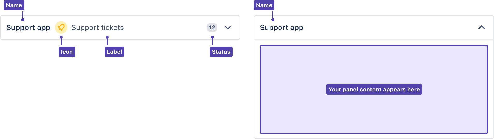

    Use a short app name and label
    Since the issue view’s context section has a limited width, use a short app name and label to ensure both are displayed fully.
    issue context anatomy
