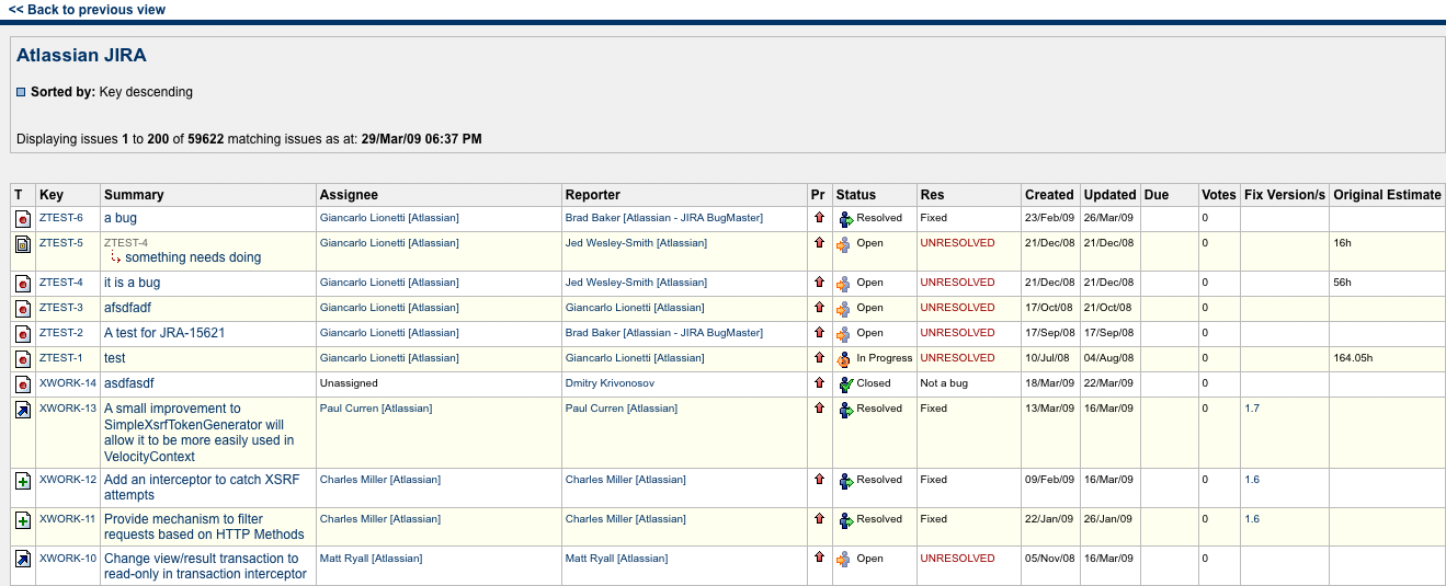

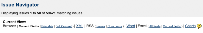

Search request view plugin modules are used to display different representations of search results in the issue navigator. They will be displayed as a link at the top of the issue navigator. Once clicked, Jira will render the search request view.
Here's what the bundled 'Printable' view looks like:

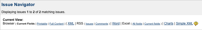

Example
Here's what the sample plugin looks like in action:
And this is a sample search result rendered by the plugin:
