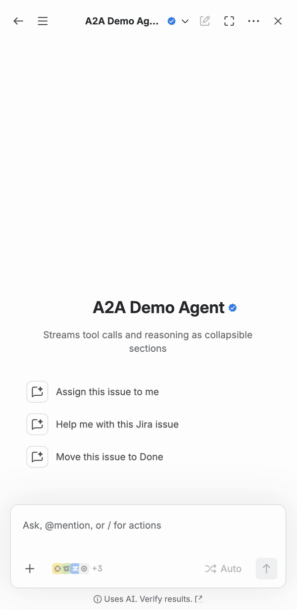

Demo
An A2A agent streams a response with three collapsed sections (two tool calls and its thinking), followed by a normal answer. Each section expands when the user clicks the chevron.
Example - An A2A agent streams a response with three collapsed sections
