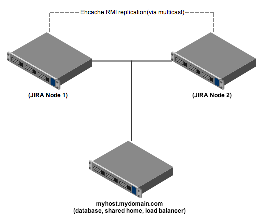

Topology
There are two options:
  1. Each node on a separate machine (more production-like)
  2. Single host configuration (easier to set up and operate for local testing)
Each Jira node (two in this example) runs on its own machine (physical or virtual), with a third machine for the shared services. In production, the shared services will most likely run on separate machines from each other.
