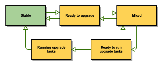

ZDU introduces a cluster state which describes what's going on with your cluster in terms of the upgrade process.
Your cluster can be in one of the following states:
  • Stable: Stable means that the cluster currently functions as normal and there is no upgrade in progress.
  • Ready to upgrade: This means the cluster is ready for an upgrade. An upgrade is performed by removing a node from the cluster, upgrading it, and then adding it back to the cluster. This state means that your cluster is ready for this to occur, but so far nothing's happened. At this point, an Admin can remove a node from the load balancer, and perform a graceful shutdown of that node to upgrade it, or just 'kill' it. We never recommend that an admin 'kills' a running Jira node, but technically they could, and as developers you should be aware of it.
  • Mixed: This state means that at least one node in the cluster has a newer version of Jira running on it, and at least one node has the original version running. At this point, the upgrade hasn't been finalized yet, and Jira hasn't run it's upgrade tasks. If required though, Jira has changed the database schema to suit the newer version of Jira.
  • Ready to run upgrade tasks: This state means that all the nodes in the cluster are now running the new version of Jira, but upgrade hasn't been finalized yet. Things can happen and we give our admins a chance to stop it right now and rollback. An admin need to  approve  the upgrade for Jira to run upgrade tasks and enable all the newer features.
  • Running upgrade tasks: This state means that an admin has just approved the upgrade, and one of Jira nodes is applying all necessary changes it needs to make the cluster up-to date and to enable all the new features.
The process:
What happens to a Jira node during ZDU?
Nothing special to be honest. An admin would upgrade the node as you would a regular Jira instance, and then add it back to the cluster. There's a few important things to note though:
  • A node receives events whenever other node changes  cluster state
  • A node can go down  SUDDENLY
  • A node can be upgraded to newer version of Jira and switch  cluster state  to MIXED
  • An upgraded node can be downgraded back to the original version of Jira and possibly switch  cluster state  back to READY TO UPGRADE if there are no nodes on a newer version
  • Once an admin  approves  the upgrade, a node will start running any required upgrade tasks
