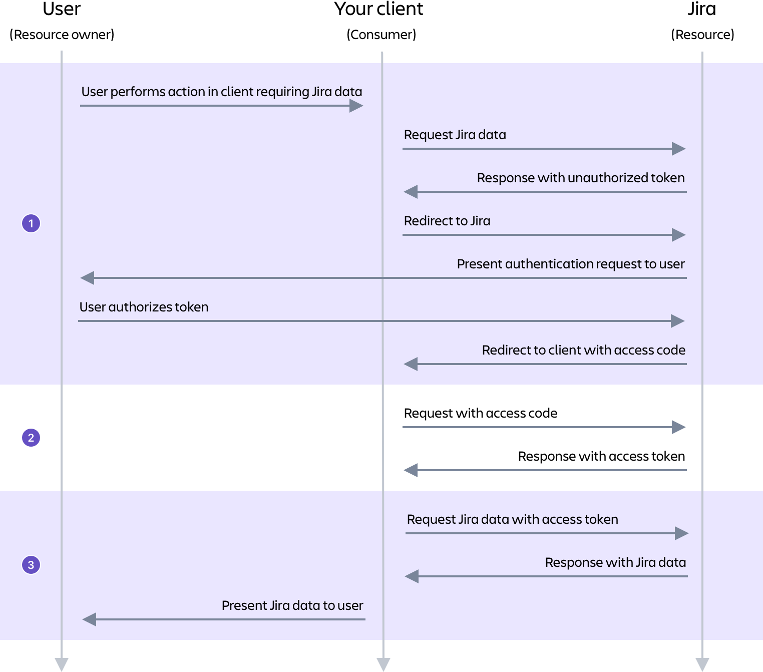

The authorization flow is shown in more detail in the following diagram.
OAuth diagram

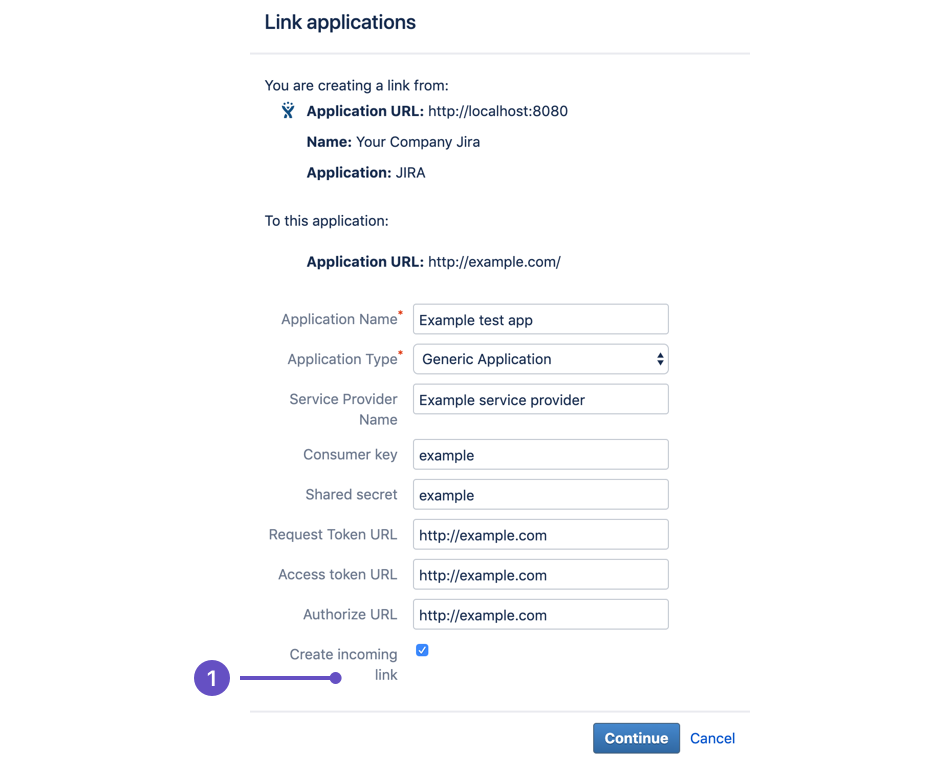

  1. In Jira, navigate to Jira settings (cog icon) > Applications > Application links.
  2. In the Enter the URL of the application you want to link field, enter any URL, for example,  http://example.com/, and then click Create new link. Ignore the No response was received from the URL you entered warning that is displayed and click Continue.
  3. On the first screen of the Link applications dialog, select the Create incoming link checkbox (1).
    First screen of application link dialog
    It doesn't matter what you enter in the remaining fields (URL, name, type, and so on). This is because we only want to retrieve data from Jira, therefore we only need to set up a one-way (incoming) link from the client to Jira.

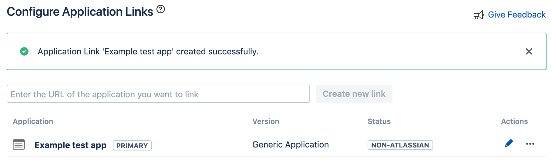

  5. Click Continue. The application link you created will show in a screen like the following.
    Application link created screen

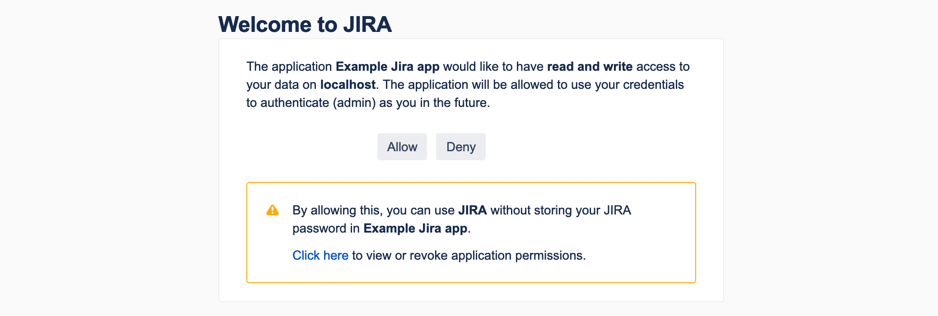

  3. In your browser, go to the URL specified in the terminal output. You'll see the following screen:
    Authorization screen
  4. Click Allow. This will authorize the request token.
    You'll see the following output in your browser:
