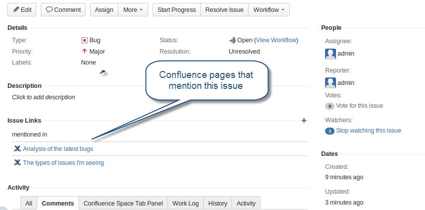

This tutorial shows you how to build a JIRA plugin that communicates with a Confluence instance through an application link. The plugin will add a panel to the issue view page in JIRA. When a user opens the issue in JIRA, the plugin searches the Confluence space linked to the JIRA project and lists the pages that mention the issue. In other words, the panel lists any page in a Confluence space that references the currently viewed issue by issue key.
Here's how it'll look:
Getting this done will require a little administration work along with your development work. First, you'll need to set up an Application Link between the JIRA instance and the Confluence installation. You will then need to configure a project link between a JIRA project and Confluence space.

Step 6. Build, install and run the plugin
Now start JIRA with the plugin:
  1. Back at the command line, change to the project home directory.
  2. Enter atlas-run.
  3. Open your browser and open the application started by atlas-run, for example, by navigating to http://localhost:2990/jira.
  4. At the login screen, enter the username of admin and a password of admin.
  5. Follow the wizard to create a new project.
  6. Keep this window open while you perform the next steps.
Next configure the Confluence instance against which you'll test your plugin as described below.  Notice that these steps include setting up an Application Link and a project link. The steps are not described in detail here. If you're new to Atlassian administration, you should see the JIRA documentation for details on how to accomplish these tasks.
  1. Start the Confluence instance against which you'll test your plugin:
    1
    2
    atlas-run-standalone --product confluence
  2. When Confluence finishes starting up, return to the browser window with JIRA opened, and navigate to the administration console.
  3. In the JIRA administration console, click the Applications Links link in the left menu.
  4. Follow the instructions in the wizard to set up a reciprocal Application Link between JIRA and your Confluence instance.
  5. Return to the Administration page of your newly created project and set up a project link between it and the built-in Demonstration space in Confluence.
  6. Create a new issue in your JIRA project.
  7. In the Demonstration space in Confluence, either create a new page or edit an existing one and add the issue key to the page. You can do this in the form of the JIRA issue macro.
  8. Save the page.
  9. Back in JIRA, view the issue you created and click the Confluence Space Tab Panel tab. You should see the title of the Confluence page in which you mentioned the issue. If you do not see your Confluence page, try re-indexing Confluence first and then try viewing the issue again.
Congratulations, that's it
