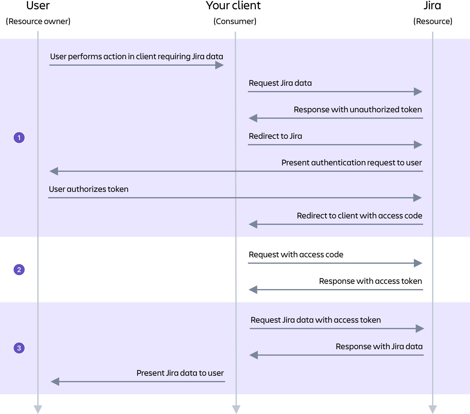

Authorization flow
OAuth is an authorization protocol that contains an authentication step. OAuth allows a user (resource owner) to grant a third-party application (consumer/client) access to their information on another site (resource). This process is commonly known as the OAuth dance. Jira uses 3-legged OAuth (3LO), which means that the user is involved by authorizing access to their data on the resource (as opposed to 2-legged OAuth, where the user is not involved).
In Jira, a client is authenticated as the user involved in the OAuth dance and is authorized to have read and write access as that user. The data that can be retrieved and changed by the client is controlled by the user's permissions in Jira.
The authorization process works by getting the resource owner to grant access to their information on the resource by authorizing a request token. This request token is used by the consumer to obtain an access token from the resource. Once the client has an access token, it can use the access token to make authenticated requests to the resource until the token expires or is revoked.
This process can be separated into three stages:
  1. The user authorizes the client with Jira to receive an access code.
  2. The client makes a request to Jira with the access code and receives an access token.
  3. The client can now receive data from Jira when it makes a request including the access token. Note, the client can continue making authenticated requests to Jira until the token expires or is revoked.
The authorization flow is shown in more detail in the following diagram.
OAuth diagram

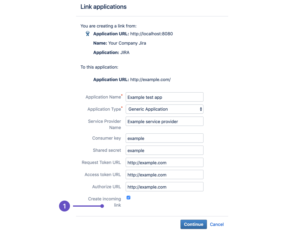

  1. In Jira, navigate to Jira settings (cog icon) > Applications > Application links.
  2. In the Enter the URL of the application you want to link field, enter any URL, for example,  http://example.com/, and then click Create new link. Ignore the No response was received from the URL you entered warning that is displayed and click Continue.
  3. On the first screen of the Link applications dialog, select the Create incoming link checkbox (1).
    First screen of application link dialog
    It doesn't matter what you enter in the remaining fields (URL, name, type, and so on). This is because we only want to retrieve data from Jira, therefore we only need to set up a one-way (incoming) link from the client to Jira.
  4. On next screen of the Link applications dialog, enter the consumer details for the sample client:
    • Consumer key = OauthKey
    • Consumer name = Example Jira app
    • Public key = Copy the public key from the jira_publickey.pem file you generated previously and paste it into this field (for example, dv5y+mjc4fZHHoLAwg...)

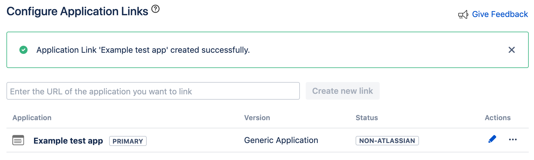

  5. Click Continue. The application link you created will show in a screen like the following.
    Application link created screen

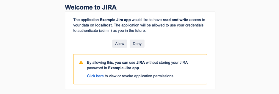

  3. In your browser, go to the URL specified in the terminal output. You'll see the following screen:
    Authorization screen
  4. Click Allow. This will authorize the request token.
    You'll see the following output in your browser:
    1
    2
    3
    4
    Access Approved
    You have successfully authorized 'Example JIRA app'. Your verification code is 'qTJkPi'. You will need to
    enter this exact text when prompted. You should write this value down before closing the browser window.
