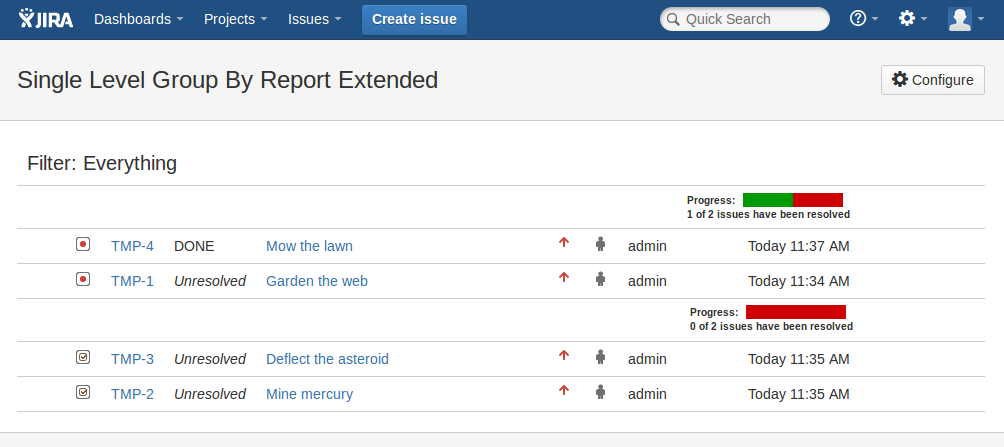

The Single Level Group By Report Extended builds on an existing report in Jira. The existing report looks like this.
When you're done, you have a new report that looks like this.
Notice that Assignee and Updated fields appear in the output.

    This is simply the original report with Atlassian Spring Scanner annotations. Next, we'll add the code that presents the time of last update to the report.
  3. Under the existing field declarations for the class, add a new field.
    1
    2
    private final DateTimeFormatter formatter;
  4. Add the new field as a parameter passed to the class constructor.
    1
    2
    public SingleLevelGroupByReportExtended( ...
                                              @JiraImport DateTimeFormatterFactory dateTimeFormatterFactory )
       this.formatter = dateTimeFormatterFactory.formatter().withStyle(DateTimeStyle.DATE).forLoggedInUser();
  5. In the generateReportHtml() method, add the following line:
    1
    2
    startingParams
                  .put("formatter", formatter).build();
    return descriptor.getHtml("view", startingParams);
    It should appear within the try block in which the code assigns values to the parameter map.
    This code appends an additional parameter to the parameter map created by the method.
  6. Save your changes.
The modified class should look something like this:

Step 6. Create the view template for the report
In this step, we edit the report view template to display the assignee and the issue's last update time. This version differs from the original Jira report in two places where we loop over the issue result set to display the time.
Let's update the resource files that the SDK gave us.
  1. Navigate to src/main/resources/templates/reports/single-level-group-by-report-extended and open the view.vm file.
  2. Replace the placeholder content with the following:

    This template code is identical to the template for the original report, but with an added table cell in the output that contains our date.

That gives us enough to try it out in Jira. You'll do that in the next step.
Step 7. Start Jira and try the report
  1. Open a Terminal and navigate to the project root directory (where the POM is located), and then run the following command:
    1
    2
    atlas-run
    Give the SDK a few minutes to download the Jira files and start the instance. If you run into build errors, make sure you have enabled the dependency for the jira-core artifact in the project POM.
  2. Open the local Jira instance and log in with the default admin/admin credentials.
  3. Before trying out your report, create a few Jira artifacts:
    1. Create a project. The first time you start Jira, a wizard prompts you to create one.
    2. Create a few test issues in the project. To give your report a property to group by, choose different assignees or issue types for your issues.
    3. Create at least one filter. You can do this from the search page. For more help, see the documentation on Jira filters.
  4. Go to the Overview page for your project.
  5. In the Summary view, find your two new reports at the bottom of the list.
  6. Click Single Level Group By Report Extended
  7. Select a Filter and the statistic type you want to group by, and then click Next. Your report should look something like this.
Take a look at how the Creation Report looks in Jira. Due to the properties you added to the app descriptor, we have our user input fields. But, there are only placeholders for labels, and if you click Next, you get a blank page. You'll work on that in the next step.
