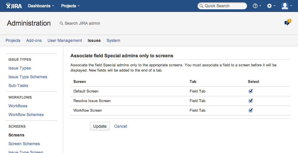

  5. To associate the Field Tab with all screens, select all checkboxes and click Next.
    Associate fields
  6. Click Update.
