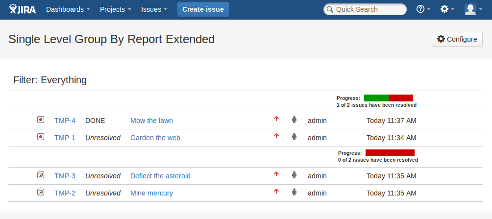

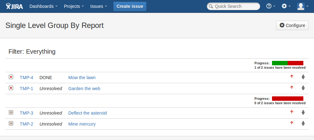

The Single Level Group By Report Extended builds on an existing report in Jira. The existing report looks like this.
When you're done, you have a new report that looks like this.
Notice that Assignee and Updated fields appear in the output.

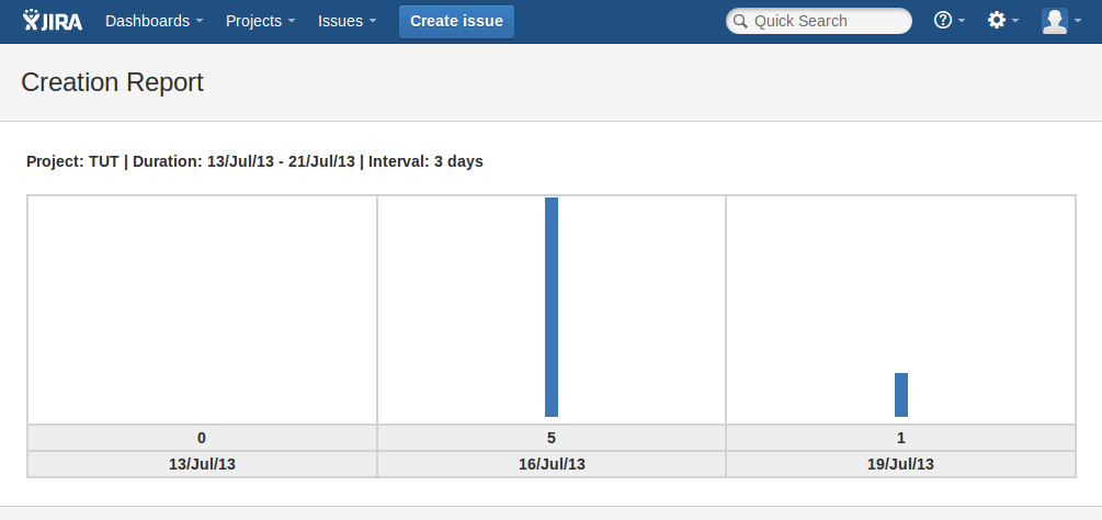

The Creation Report displays a histogram of issues created over a specified time and broken into certain intervals of time.

    <table width="100%" class="aui" id="single_groupby_report_table">
        <thead>
        <tr>
            <th colspan="6">
                <h2>$i18n.getText('report.singlelevelgroupby.mapper.filterid.name'): $textutils.htmlEncode($searchRequest.name)</h2>
            </th>
        </tr>
        </thead>
        <tbody>
            #foreach ($option in $statsGroup.entrySet())
                #set ($issues = $option.value)
                #set ($graphModel = $statsGroup.getResolvedIssues($option.key))
            <tr>
                <th colspan="6" class="stat-heading">
                    <div class="stat-progress">
                        <span class="graphLabel">$i18n.getText("common.words.progress"):</span>
                        #percentageGraphDiv ($graphModel)
                        #if ($issues.size() > 0)
                            <span class="graphDescription">$i18n.getText("roadmap.issuesresolved", "$statsGroup.getResolvedIssueCount($issues)", "$issues.size()")</span>
                        #end
                    </div>
                    <h3>#statHeading ($mapperType $option.key $customFieldManager "${urlPrefix}$!searchService.getQueryString($user, $statsGroup.getMapper().getSearchUrlSuffix($option.key, $searchRequest).getQuery())")</h3>
                </th>
            </tr>
                    #foreach ($issue in $issues)
                    <tr>
                        <td width="5%"> </td>
                        #issueLineItem ($issue)
                        <td nowrap class="assignee">
                            #if($issue.getAssignee())
                                $issue.getAssignee().getDisplayName()
                            #else
                                $i18n.getText('common.concepts.unassigned')
                            #end</td>
                        <td nowrap class="last-updated"> $formatter.format($issue.getUpdated())</td>
                    </tr>
                    #end
                #else
                <tr>
                    <td colspan="6">
                        <span class="subText">$action.getText("common.concepts.noissues").</span>
                    </td>
                </tr>
                #end
            #end

    This template code is identical to the template for the original report, but with an added table cell in the output that contains our date.

  6. Click Single Level Group By Report Extended.
  7. Select a Filter and the statistic type you want to group by, and then click Next. Your report should look something like this.
Take a look at how the Creation Report looks in Jira. Due to the properties you added to the app descriptor, we have our user input fields. But, there are only placeholders for labels, and if you click Next, you get a blank page. You'll work on that in the next step.

Step 9. Develop the Creation Report UI
If you try the report in Jira now, you will still get a blank page. To see a report, you need to code a presentation template, along with text strings that will appear in the UI.
  1. Navigate to src/main/resources/templates/reports/creation-report and open the view.vm file.
  2. Replace its content with the following:
    1
    2
    3
    4
    5
    6
    7
    8
    9
    10
    11
    12
    13
    14
    15
    16
    17
    18
    19
    20
    21
    22
    23
    24
    25
    26
    27
    28
    29
    30
    31
    32
    33
    34
    <div style="padding: 5px">

Step 10. View the finished report
Now try the Creation Report again and see what we've got.
  1. Start Jira instance using atlas-run command or, if you left Jira running, simply rebuild your app with atlas-package command. As mentioned,  QuickReload will automatically reinstall your app for you.
  2. At the bottom of the project summary page, click the Creation Report link.
  3. Supply dates that follow these criteria:
    1. Dates make a range that encompasses the date on which you created the issues.
    2. The interval is long enough to give you a few intervals to look at (keep in mind that the default interval is 3 days).
  4. Click Next.
    This time, we have a report.
Congratulations, that's it!
