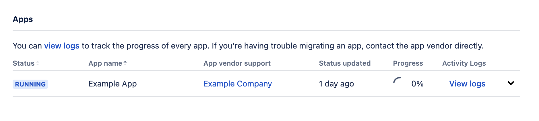

You can download progress logs from the migration assistant in the migration plan screen, on the This migration includes tab, by selecting View logs:
Preview of View Logs link

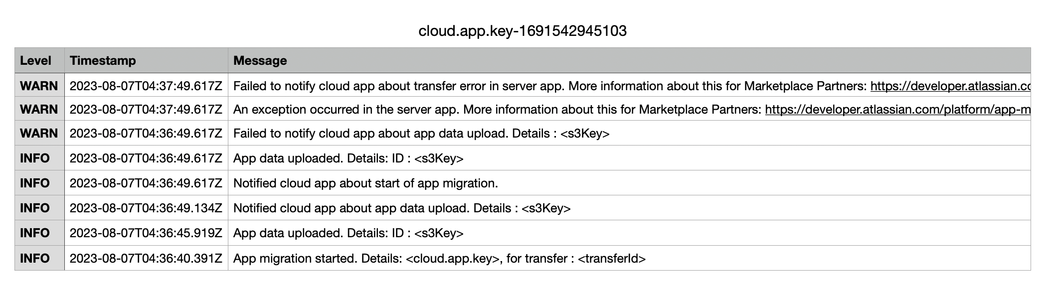

The logs are downloaded as a CSV file, as shown in this example:
Example progress log CSV

Explanation of Progress Logs
Information Progress Logs
These are expected progress logs that occur during an app migration.
MessageExplanation
App migration started. Details: {cloudAppKey}, for transfer: {transferId}Logged at the start of the app migration. Use the transfer ID to correlate progress logs with your internal logs.
App data uploaded. Details: ID: {s3Key}App data has been uploaded to cloud storage. Learn more about retrieving app data
Notified cloud app...Your cloud app has successfully responded to a webhook call.
App migration updated by the Cloud app with status {status}, progress {percent} and message: {message}Represents a status update provided by your cloud app. The entry includes up to 1000 characters of your message.
Initiated your request to cancel app migration.A customer has requested to cancel a transfer.
Older logs have been omitted for transfer: {transferId}There are too many log entries to return, so older entries are omitted.
Warning Progress Logs
These logs could impact the success of a migration.
MessageExplanationSuggestions
An exception occurred on the server appAn uncaught exception has occurred in the server-side listener method (onStartAppMigration), possibly preventing the execution of further code. This could cause the app migration to ultimately time out.To avoid a stuck migration, we recommend that your cloud app updates the transfer to a settled status. Refer to server-side-exceptions for more detail.
Cloud app is not registered to receive migration notifications...We could not find a webhook to notify your cloud app of the given event, e.g., app data upload. Note there is a check run before migration that is related to this warning.We recommend that your cloud app has added a webhook URL in the connect descriptor while maintaining the registered webhook. The customer should also ensure the cloud site is available with an active license during the migration.
Failed to notify Cloud app...Your cloud app failed to return a 200 OK response for a webhook event after multiple retries.Ensure your cloud app is returning a success response in a timely manner. Read more about webhooks here.
