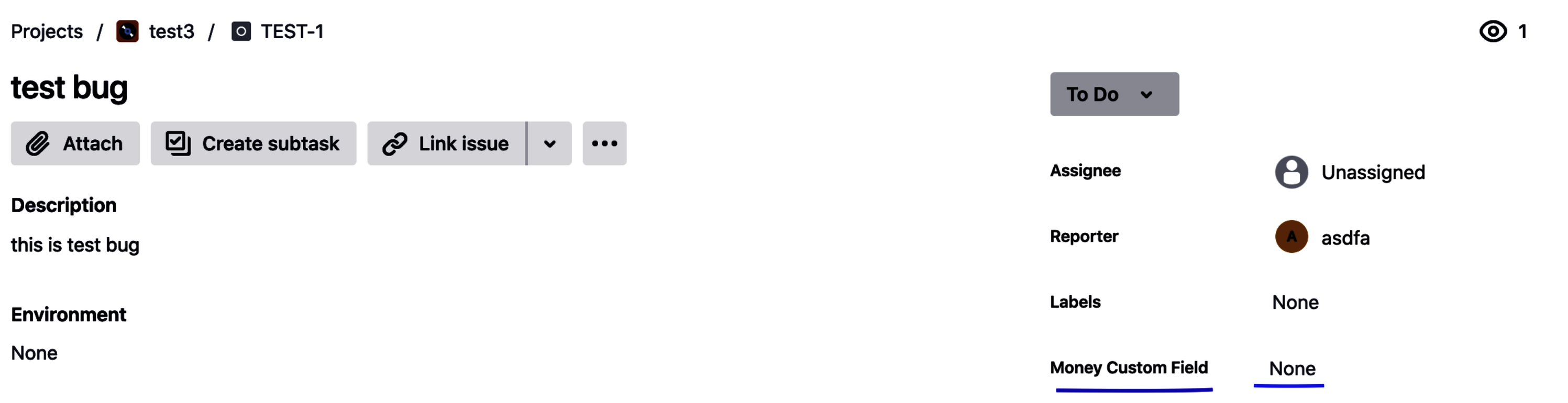

Your cloud app custom fields appear on the same screens as the corresponding server app custom fields. Your app custom field is visible for migrated project issues as shown in the snapshot below.
Migrated-Jira-App-Custom-Field
After your app custom field reference is available in Jira cloud, its value will be empty. You can use the Bulk update custom field value (Connect) or Update custom fields (Forge) APIs to populate the custom field value from your cloud app.
