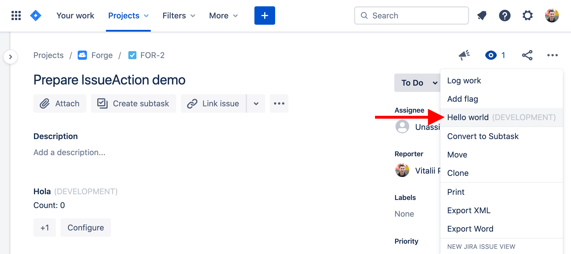

The jira:issueAction module adds a menu item to the more actions (•••) menu on the issue view. When the menu item is clicked, the module’s function renders a modal dialog.
This module can be used in Jira and Jira Service Management. It works in the new issue view but not the old issue view.
Example of an Issue action button

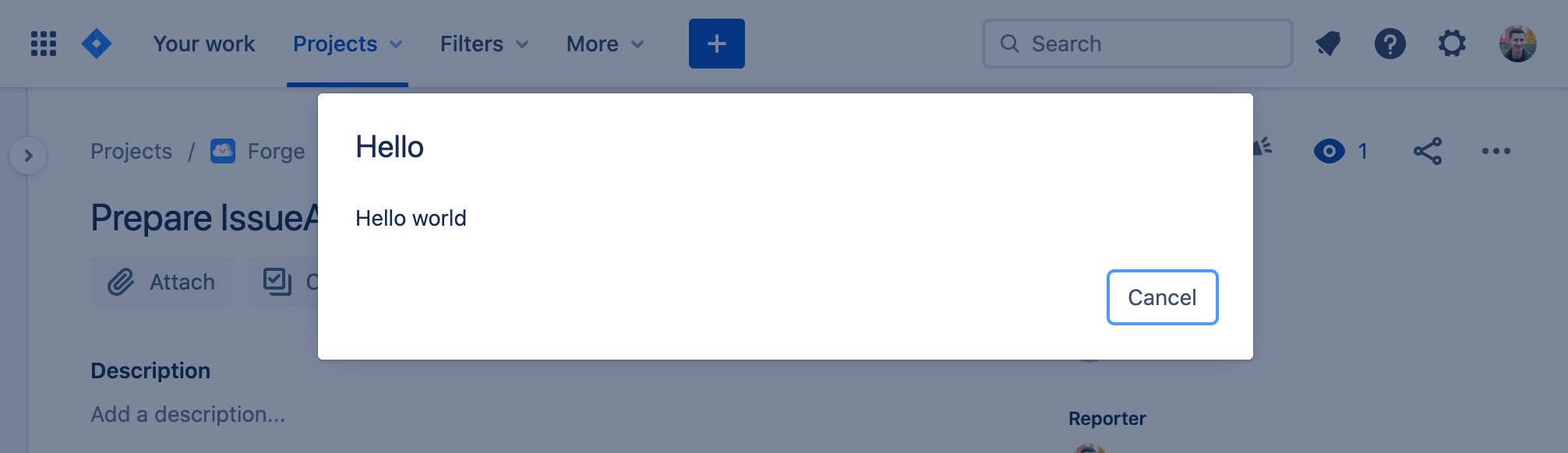

This is an example of the triggered modal dialog:
Example of an Issue action with the above sample code
