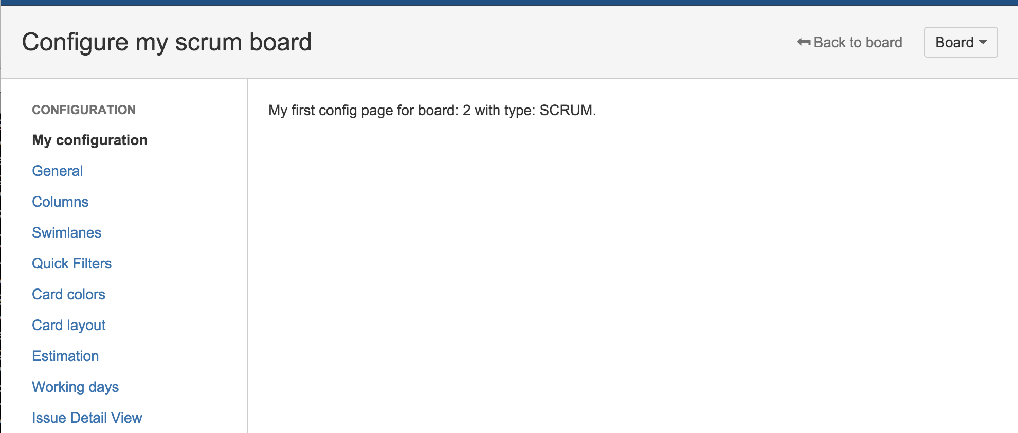

In this tutorial, you will build a board configuration page for your Jira Software Data Center app. We won't go into the details of adding settings to the page, but this tutorial will provide a good starting point if you want your app to have separate configurations per board.
To create this board configuration page, you'll create a new web panel located in jira.agile.board.configuration, and then add code to render the web panel. That's it!
This is what it will look like:

Note that two context parameters are available in the template for you to use: $board.id and $board.type.
You can see the mentioned parameters in the following example:
1
2
{namespace My.addOn.tpl.board.config}
    Custom configuration page.
    @param board
{template .myConfigurationPage}
    My first config page for board: {$board.id} with type: {$board.type}.
{/template}
Congratulations! You've just built a board configuration page for your Jira Software P2 app.
