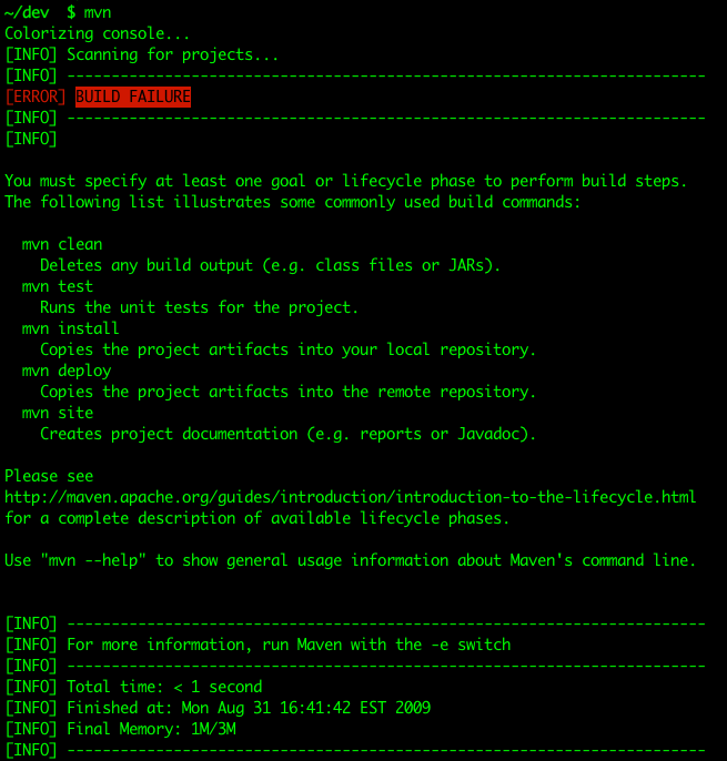

Colour-coding your Maven output
If you are using the Atlassian Plugin SDK in a Unix, Linux, or macOS environment, you can ensure that your Maven output comes in true colour. Just set the MAVEN_COLOR environment variable to true:
1
2
export MAVEN_COLOR=true
Your Maven output will look something like this: mavencolourisedoutput.png

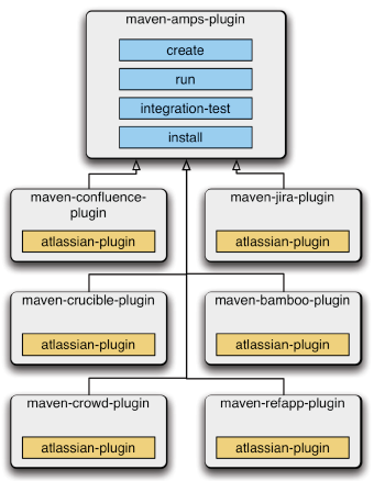

AMPS architecture
As a suite of Maven plugins, AMPS combines multiple plugins, conventions, and POM configuration.
Diagram: AMPS architecture:
The product-specific configuration is as follows:
Product
AMPS plugin
Bamboo
bamboo-maven-plugin
Bitbucketbitbucket-maven-plugin
confluence-maven-plugin
Crowd
crowd-maven-plugin
Fisheye/Crucible
fecru-maven-plugin
jira-maven-plugin
Refapprefapp-maven-plugin
