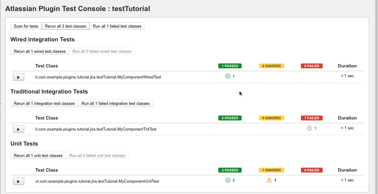

    The test console appears. The console lists the type of tests it found in your project.
  4. Press Rerun all 3 test classes to run your tests and display their results:

  4. The test console appears. The console lists the type of tests it found in your project.
  5. Press Rerun all 3 test classes to run your tests and display their results
